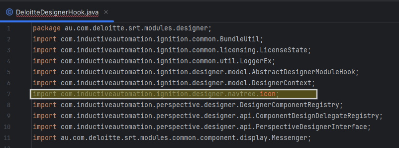

I tried to put a reference of the package you mentioned before on my designer hook
 ![image](https://us1.discourse-cdn.com/inductiveautomation/original/3X/d/0/d0be14116b76f9c42b53256b5674ffa7ca5c2e85.png)
But it seemed couldn’t find the package.
 ![image](https://us1.discourse-cdn.com/inductiveautomation/original/3X/0/a/0abaf0d0ef0e29a95e88bcd8253d9ec4a10bb927.png)
Regards
**Post date:** [November 21, 2025, 12:10am UTC](https://forum.inductiveautomation.com/t/icon-size-for-custom-perspective-module/112293/4 "2025-11-21T00:10:01Z")
You need to import something from that package.
