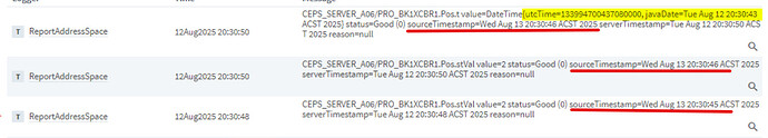

**Post date:** [August 12, 2025, 11:28am UTC](https://forum.inductiveautomation.com/t/iec-61850-alarm-time/90647/8 "2025-08-12T11:28:38Z")
Can you verify the date and time on both the Ignition server and your RTU (both the intermediate and downstream) are correct?
I noticed in the log screenshot you sent support that the SourceTimestamps are a full day ahead of the other timestamps for some reason:

Hi Kevin, I've realised that ignition uses the report timestamp as the Alarm timestamp source.
As I have:
IED \>\> RTU \>\> Ignition
The report timestamp is not actually generated in the IED. Once I have all devices synced to PTP clock source it will be more accurate, but I'm hoping to generate an alarm based on the .stVal and .t returned from the IED (via the RTU).

I think it may be difficult, as you noticed initially, data change notifications for `stVal` and `t` arrive independently and without any guarantee of order.
This is true for all values from all OPC UA servers - the only way to guarantee independent values arrive together in a data change notification is for a server to expose them in a structured value and for the client to subscribe to the structured value. And this assumes the underlying data source can update atomically.
When the 61850 driver receives a report for `stVal` (and any other point where this is appropriate) it takes care to use the associated quality and timestamp when it constructs the OPC UA DataValue. After that any special relationship between `stVal` and `t` is lost - it only exists in 61850, not in OPC UA, and not in Ignition.
Hopefully somebody here or in support has some tricky alarm solution for you.
