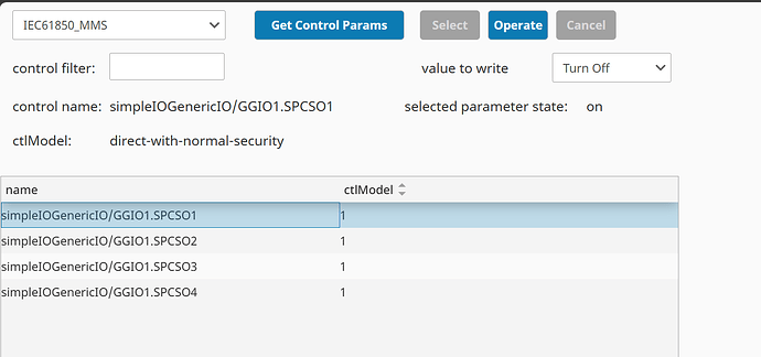

I also imported the view where you control parameters in inductive university IEC61850 lesson and i can choose my drive and 4 parameters are shown in table as in snip below
 ![image](https://us1.discourse-cdn.com/inductiveautomation/original/3X/d/0/d00cd276bae19dee71af3f32ae807da786ee2f89.png)

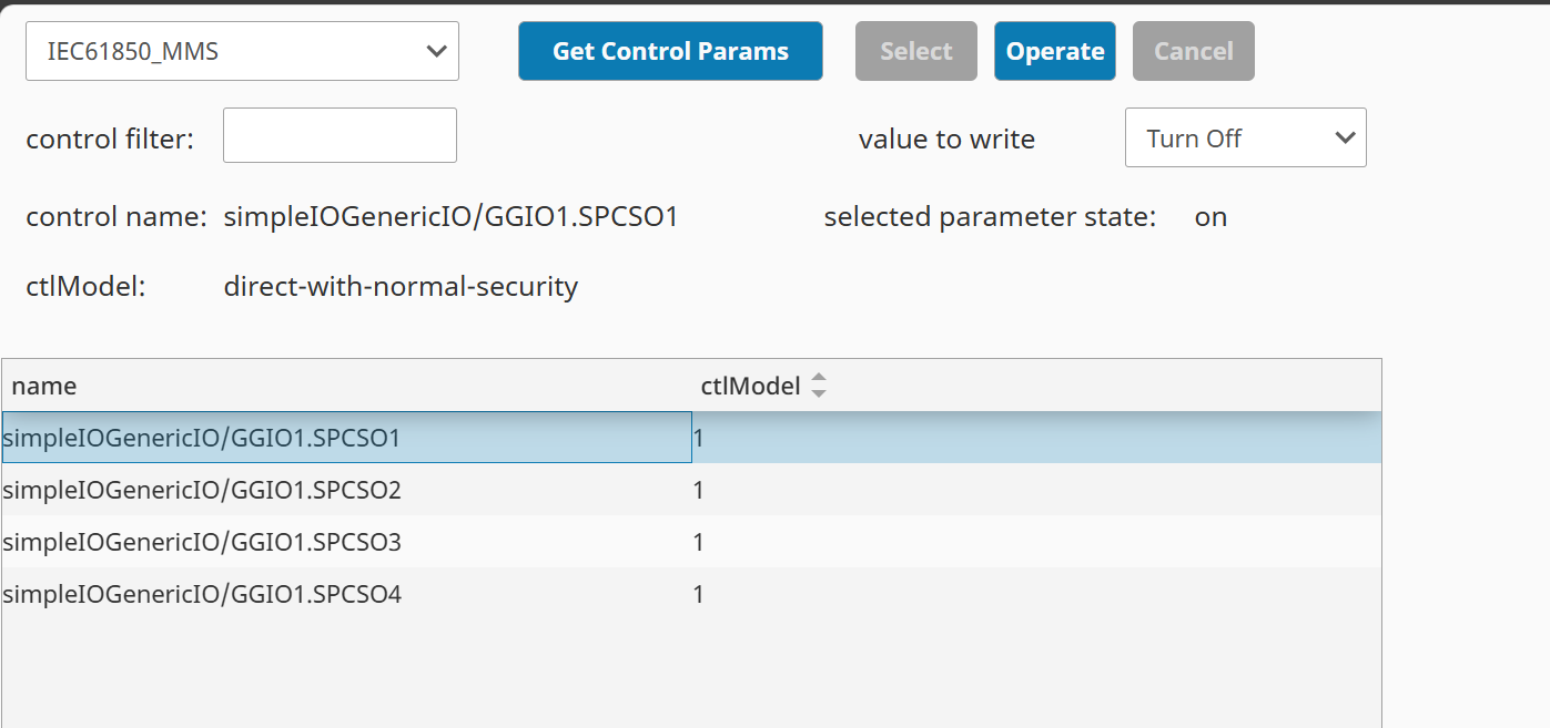

from this snip, i modified the old braker state to be **‘selected parameter state‘** with indirect binding to show status of selected row of table component and i changed dropdown **'write to value‘** to choose true or false instead of 0,1,2
but when i select from dropdown and click ‘ **operate** ‘, nothing happens! and i have this error in snip below
 ![image](https://us1.discourse-cdn.com/inductiveautomation/original/3X/0/a/0a3f6d180fd3253e40cc481f9316dbeaf5349fa3.png)
also where are the other parameters?like in snip below, i can read them in ignition but they are not shown in table!
 ![image](https://us1.discourse-cdn.com/inductiveautomation/original/3X/1/2/12104b5f66f45d993577292e6d7f711db18b6ebd.png)
**Author:** ![Cody\_Morgan](https://avatars.discourse-cdn.com/v4/letter/c/db5fbb/32.png) [@Cody\_Morgan](https://forum.inductiveautomation.com/u/Cody_Morgan)\
**Post date:** [September 4, 2025, 8:40pm UTC](https://forum.inductiveautomation.com/t/iec61850-scd-file/110244/14 "2025-09-04T20:40:22Z")
We've exhausted my 61850 knowledge, and I'm unfamiliar with the "view" that you're using from the university course. This might be a good exercise for me as well, so if I get around to trying it out, I'll try to let you know what's going on here.
