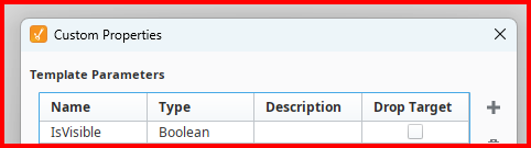

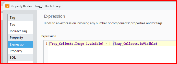

**Author:** ![andy.hernandez](https://avatars.discourse-cdn.com/v4/letter/a/4491bb/32.png) [@andy.hernandez](https://forum.inductiveautomation.com/u/andy.hernandez)\
**Post date:** [July 29, 2025, 1:32pm UTC](https://forum.inductiveautomation.com/t/if-opc-tag-is-true-then-visibility-is-false/109056/8 "2025-07-29T13:32:40Z")
Steps 1 and 3 done. I need more data for Step 2 where is this (custom property) located at?
 ![image](https://us1.discourse-cdn.com/inductiveautomation/original/3X/6/2/627bd089fd0ca53e358706e4abca262227df5f06.png)
 ![Screenshot 2025-07-29 092802](https://us1.discourse-cdn.com/inductiveautomation/original/3X/8/c/8c49df2859e71cb70084d3fd75d015789e8d9389.png)
 ![Screenshot 2025-07-29 092949](https://us1.discourse-cdn.com/inductiveautomation/original/3X/5/9/5980d1d19d7f08b46c10a0cc70f7e06d83500423.png)
**Post date:** [July 29, 2025, 1:38pm UTC](https://forum.inductiveautomation.com/t/if-opc-tag-is-true-then-visibility-is-false/109056/9 "2025-07-29T13:38:17Z")
For two, if you click on the template, your custom property should now appear at the bottom of the property list in the property browser.
For your step 3, you have done this incorrectly.
1. Expressions do not assign values, they return a result.
The binding should literally be:
```python
!{Tray_Collects.IsVisible}
**Post date:** [July 29, 2025, 1:42pm UTC](https://forum.inductiveautomation.com/t/if-opc-tag-is-true-then-visibility-is-false/109056/10 "2025-07-29T13:42:50Z")
Thanks for fixing Step 3
For step 2 the new properties do show up at the bottom, but I cannot click on it to bind it to the OPC tag. How or where is the actual binding done?
 ![image](https://us1.discourse-cdn.com/inductiveautomation/original/3X/c/5/c5d33501eadc23d40b11f61543d99879db000ba5.png)
**Post date:** [July 29, 2025, 1:51pm UTC](https://forum.inductiveautomation.com/t/if-opc-tag-is-true-then-visibility-is-false/109056/11 "2025-07-29T13:51:09Z")
You created a template parameter, which you may want to do with a "Tag Path" parameter, but that's a different issue.
Instead, in this instance you want to create an Internal Property. Then you will be able to bind it.
Parameters are expected to get their values from outside of the template.
**Post date:** [July 29, 2025, 1:54pm UTC](https://forum.inductiveautomation.com/t/if-opc-tag-is-true-then-visibility-is-false/109056/12 "2025-07-29T13:54:20Z")
Grateful for your help—that was exactly what I needed
