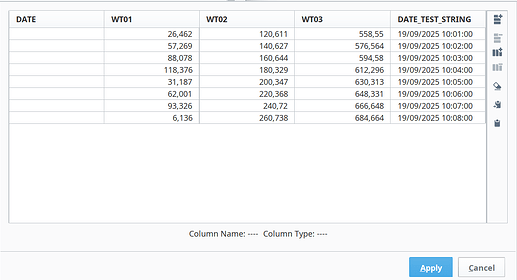

@robertm
The administrator privileges are blocked on this machine. I am restarting the gateway “manually” by resetting the computer.
I tested it with a column defined “DATE\_TEST\_STRING" as a string type to see if the data would be lost.
before restarting the machine
 ![Captura de tela 2025-09-19 132744](https://us1.discourse-cdn.com/inductiveautomation/original/3X/1/c/1c7d2b8466056d22b03a12e8bfdf0d9ace74d67e.png)
after restarting the machine
 ![Captura de tela 2025-09-19 142414](https://us1.discourse-cdn.com/inductiveautomation/original/3X/1/b/1b5fb3c5af4fede354319928f888df2d01040a39.png)
**Post date:** [September 19, 2025, 7:01pm UTC](https://forum.inductiveautomation.com/t/ign-11942-when-working-with-a-dataset-type-date-values-are-lost-when-restarting-the-computer/110751/19 "2025-09-19T19:01:04Z")
> [@matheus.santos](#):
> everything seems to be fine
Except that values don’t seem to be making it to the internal DB.
I’m not sure what registering the gateway has to do with your issue. That was not the question that Paul asked.
Something appears to be interfearing with a memory tag persisting its value, so I at least would expect there to be some type of error, even if it’s only listed in the wrapper log.
Upload a copy of your wrapper log. If you don’t know where to get that, then ask that question.
**Author:** ![avaughn](https://sea1.discourse-cdn.com/inductiveautomation/user_avatar/forum.inductiveautomation.com/avaughn/32/38972_2.png) [@avaughn](https://forum.inductiveautomation.com/u/avaughn)\
**Post date:** [September 19, 2025, 7:05pm UTC](https://forum.inductiveautomation.com/t/ign-11942-when-working-with-a-dataset-type-date-values-are-lost-when-restarting-the-computer/110751/20 "2025-09-19T19:05:39Z")
What locale is being used on your system?
Edit: If you are running into the bug I think you are then the workaround would be to set the gateway’s language to English by adding this additional parameter to the ignition.conf file. Just make sure you replace the `X` with the next available integer according to your .conf file.
`wrapper.java.additional.X=-Duser.language=en`
**Post date:** [September 19, 2025, 7:21pm UTC](https://forum.inductiveautomation.com/t/ign-11942-when-working-with-a-dataset-type-date-values-are-lost-when-restarting-the-computer/110751/21 "2025-09-19T19:21:24Z")
So the data is there, just some issue with persistence on date\_time type.
