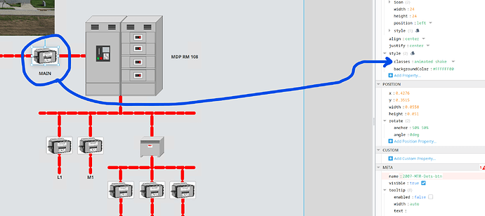

I still feel that my Perspective module theme classes are not linked to this new file location, or there is another bug during installation. Looking at the file path through the “core” folder, I don’t see the default Light and Dark themes. See image below.
 ![core_themes](https://us1.discourse-cdn.com/inductiveautomation/original/3X/7/6/76172fab27ee615bbb839d28bc89d45d6978af7c.png)
 ![designer_shake](https://us1.discourse-cdn.com/inductiveautomation/original/3X/2/8/28a2896e645f25c1f5a8f047369d141d3a0afbd6.png)
 ![shake](https://us1.discourse-cdn.com/inductiveautomation/original/3X/4/7/4721d3e5f6e4faad9647d6550b308128c69a7489.png)
 ![config_index_resources](https://us1.discourse-cdn.com/inductiveautomation/original/3X/1/3/135eb754f3b2ebf8f77ba75aa6094bd78c316609.png)
 ![attention_seeker-shake](https://us1.discourse-cdn.com/inductiveautomation/original/3X/6/8/686e2eb079470a1c08d5f9bfa242cd403aa9f6dd.png)

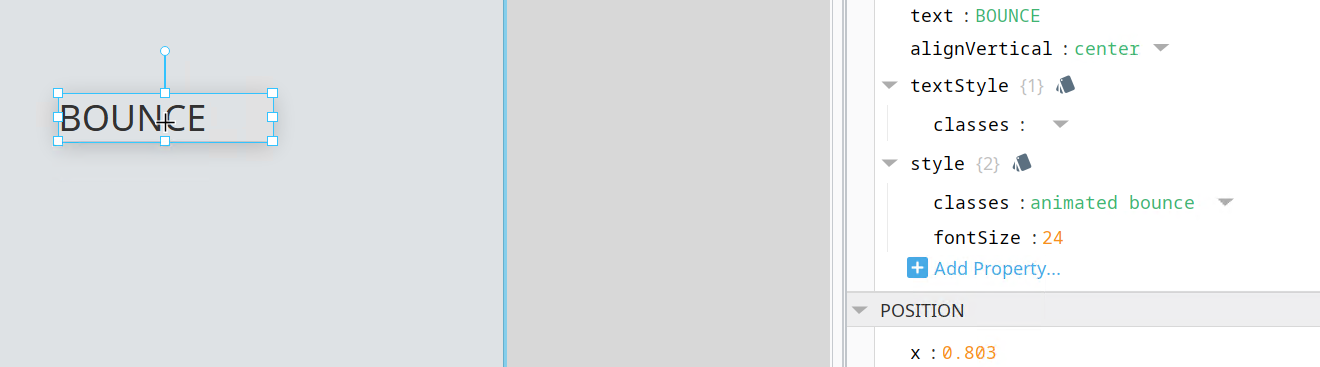

Animations are not working. I tried adding another label and assigned it a simple one, “bounce” but it still doesn’t work. I still think the link to the attention seekers is broken.
 ![bounce](https://us1.discourse-cdn.com/inductiveautomation/original/3X/6/4/6476f8a7bbe41fcb394f1d0965b00d34d75280a3.png)
**Author:** ![ynejati](https://sea1.discourse-cdn.com/inductiveautomation/user_avatar/forum.inductiveautomation.com/ynejati/32/6093_2.png) [@ynejati](https://forum.inductiveautomation.com/u/ynejati)\
**Post date:** [September 26, 2025, 9:49pm UTC](https://forum.inductiveautomation.com/t/ign-13768-perspective-custom-theming-not-working-after-8-3-migration/109114/26 "2025-09-26T21:49:50Z")
DM me this light-animations theme and I'll have a look.
**Author:** ![Tyler\_Dixon](https://avatars.discourse-cdn.com/v4/letter/t/e56c9b/32.png) [@Tyler\_Dixon](https://forum.inductiveautomation.com/u/Tyler_Dixon)\
**Post date:** [September 26, 2025, 9:57pm UTC](https://forum.inductiveautomation.com/t/ign-13768-perspective-custom-theming-not-working-after-8-3-migration/109114/27 "2025-09-26T21:57:14Z")
I still have 8.1 on my local machine and tried out the “bounce” animation with no problems. Here are is the light-animation files link & dev details and a link to a video from TheWebPleb on how to use them.

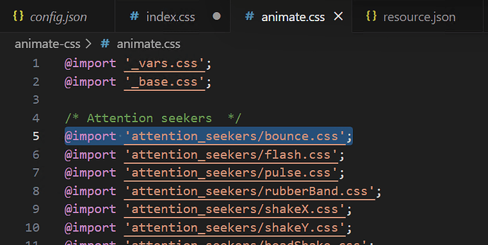

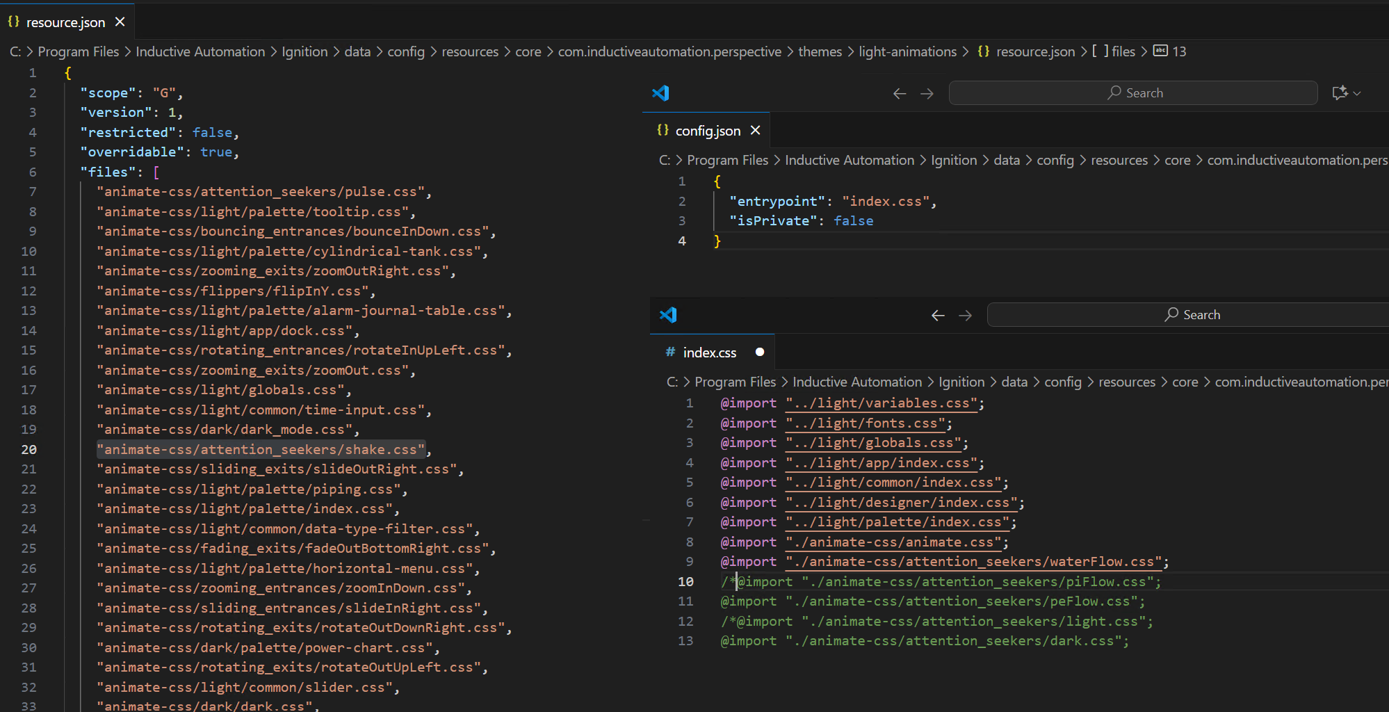

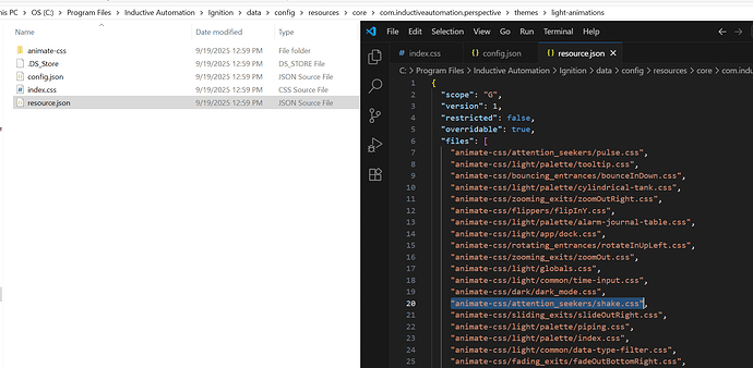

Another thing I noticed with 8.3 upgrade and themes, it did not include the file paths for the themes.digest.json file. It had the old “data/modules/com.inductiveautomation.perspective/”
Here is what I edited it for each themes, and using the “bounce” as the example/test.
"data\\config\\resources\\core\\com.inductiveautomation.perspective\\themes\\light-animations\\animate-css\\attention\_seekers\\bounce.css"

I imagine the files need to be listed as resources to cause them to be **served** when referenced by the browser, and included as CSS imports to **be** referenced by the browser. 🤷‍♂️

No need for that. Browser understand and use CSS files and import keyword inside them.
And config.json define where to start theme file as a resource in 8.3. the resource.json is somehow make everything duplicated
**Post date:** [September 30, 2025, 1:23pm UTC](https://forum.inductiveautomation.com/t/ign-13768-perspective-custom-theming-not-working-after-8-3-migration/109114/35 "2025-09-30T13:23:21Z")
> [@nader.chinichian](#):
> No need for that.
Yes, there's a need. The gateway is not exposing a filesystem as in v8.1. It is exposing **resources**. The list in the resource is for the gateway to allow them to be served. The import in the CSS makes the browser request them. You are asking for the gateway to **infer** the need to serve those resources, which would require the gateway to **parse** the CSS. It doesn't do that, and I doubt it ever will (risking security holes, if nothing else).

@ynejati @paul-griffith

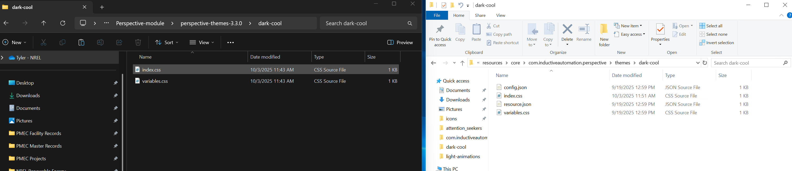

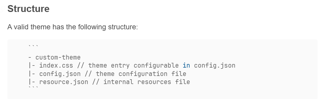

Been digging into this more, and I thought maybe when I migrated from 8.1 to 8.3 that some sort of issues were created by getting the incorrect base themes. So I wanted to test a theory and I went to the following link, [Current Ignition Release | Inductive Automation](https://inductiveautomation.com/downloads/ignition/8.3.0) , downloaded the Perspective Module, then extracted the base theme folder and themes and noticed that the theme structure you mentioned above was missing from most of the themes from that link. Left image shows the dark-cool theme from the fresh install of 8.3. Right image shows the upgrade/migration from 8.1 to 8.3. My question to you, why would a fresh installation of Ignition 8.3 not contain the base themes with theme structure you mentioned above, e.g. dark-cool?
 ![Theme structure](https://us1.discourse-cdn.com/inductiveautomation/original/3X/9/d/9d37786b3a52610da0c39be51dca4caf81f701e8.png)
 ![Theme Files](https://us1.discourse-cdn.com/inductiveautomation/original/3X/1/f/1f6c4688003841085126a51ecae50801932cbe6a.png)

There was nothing wrong with your theme. I had to get it from support. Looked like you were running into a bug where a resource.json and config.json was getting created in the root theme folder upon migration due to a legacy `.backup` directory. A fix is going through QA. In the meantime, just remove those and it should work with theme as you had it in 8.1, not the one you tried to fix after migration (that thing was too far gone). If you add your theme folder from your 8.1 backup to the old 8.1 location on the 8.3 Gateway (modules/com.inductiveautomation.perspective/themes), and then restart your Gateway, it will perform a migration. No need to do a complete restore. Just make sure you delete the existing one in `config` before doing the migration, otherwise you'll run into conflicts.
