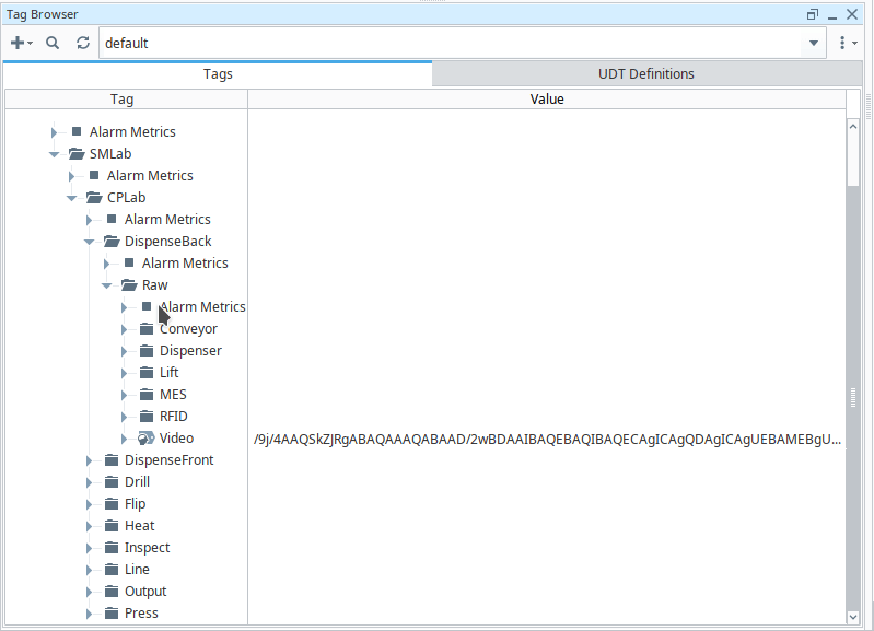

4. In the tag browser of the designer on Debian 12, tag values are invisible and/or flicker. Values are being periodically written to the default tag provider from a remote device, but I don’t believe the tag value changes account for the flicker.

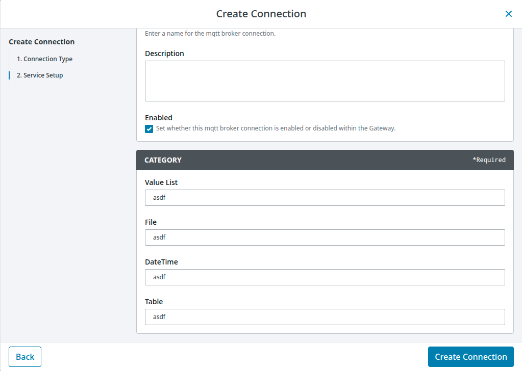

4. I am having trouble figuring out how to use multiple `FormFieldType`s as shown in the example below. May I please have some pointers on how to properly use these? I see that the Kafka connector has a list/table input, which is what I am expecting from `@FormField(FormFieldType.VALUE_TABLE)`/`@FormField(FormFieldType.VALUE_TABLE)`.

```java
public record HmSettings(
        // UI is like @FormField(FormFieldType.TEXT), not an editable list
        // Error: {"messages":["java.lang.IllegalStateException: Expected BEGIN_ARRAY but was STRING at path $.testList"],"fieldMessages":[]}
        @FormCategory("Category")
        @Label("Value List")
        @FormField(FormFieldType.VALUE_TABLE) // If commented out, causes "Application Error \n An application error has occurred. \n Check browser console for details"
        @Required
        @ListType(String.class) // Also tried LinkedList.class
        List<String> testList,
        // UI is like @FormField(FormFieldType.TEXT), not file picker/browser
        // Input can be any string
        @Label("File")
        @Required
        @FormField(FormFieldType.FILE)
        String testFile,
        // UI is like @FormField(FormFieldType.TEXT), not date picker
        // Input must be a parseable date like '2025-08-10T10:00:00Z'
        @Label("DateTime")
        @Required
        @FormField(FormFieldType.DATETIME)
        Date testDatetime,
        // UI is like @FormField(FormFieldType.TEXT), not editable table
        // Error: {"messages":["java.lang.IllegalStateException: Expected BEGIN_ARRAY but was STRING at path $.testTable"],"fieldMessages":[]}
        @Label("Table")
        @Required
        @ListType(TestType.class) // Also tried with this commented out, makes the UI input field disappear/invisible
        List<TestType> testTable
        public record TestType(
                @Label("Data1")
                @Required
                String data1,
                @Label("Data2")
                @Required
                String data2
Resulting Output:
 ![ignition-create-connection-dialog](https://us1.discourse-cdn.com/inductiveautomation/original/3X/8/9/894240a0d6e922a5c01173f003eef1b1168c4746.png)
I'm actively working on some other refinements to the tag browser (caused by incidental changes in gateway \<-\> designer communications) that hopefully iron this out ~soon.

Did we ever get an answer to Matt’s Question 4? I’m too curious on this. I’m looking for the same exact functionality to allow users to enter multiple bootstrap servers like the Kafka connector. I also haven’t found a way for _FormFieldType.VALUE\_TABLE_ to work. Is this the right way to go about it? If so, any examples? Thanks in advance!
**Post date:** [September 10, 2025, 2:47am UTC](https://forum.inductiveautomation.com/t/ign-13880-ignition-8-3-sdk-serviceconnectorextensionpoint-bugs-requests-questions/109567/9 "2025-09-10T02:47:53Z")
The Kafka "Bootstrap Servers" property is annotated with `@ListType(String::class)`.
There are not currently any uses of `FormFieldType.VALUE_TABLE` in the Ignition codebase... I can't say for sure if it works.
edit: ah, and it's a custom react page, so that may be why it has that component and not the annotation...
