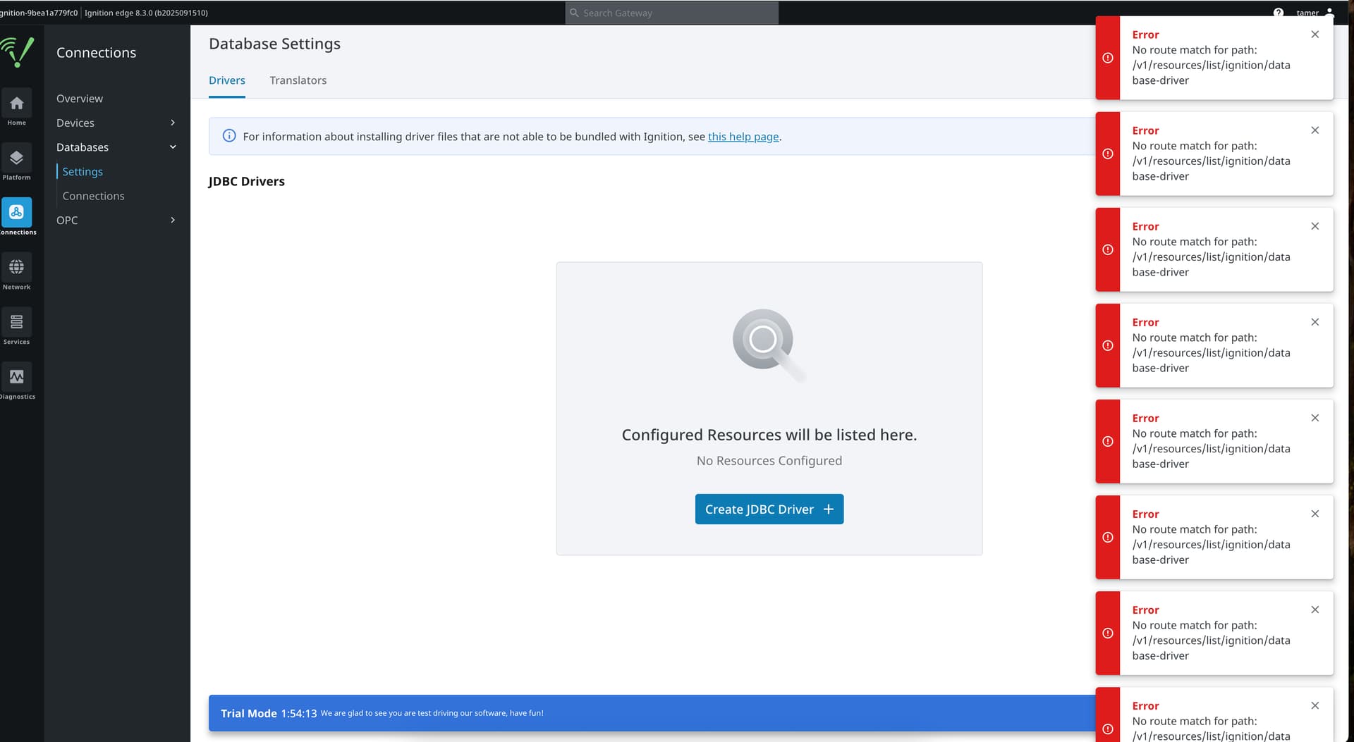

Running Edge in docker getting these errors
 ![image](https://us1.discourse-cdn.com/inductiveautomation/original/3X/b/4/b4b844049981b4723fcbadf01aa2b71c638870ab.jpeg)

Hello @nabila
I can confirm the same errors in docker for Edge. I believe that this error might be caused by the fact that Edge doesn’t allow SQL databases.
See Bottom of [Manual Page](https://www.docs.inductiveautomation.com/docs/8.3/other-editions/ignition-edge)
That being said, it seems like something that should be removed on Edge Gateways to minimize confusion.

Thank you for bringing this to our attention! I was able to replicate this issue locally as well and a ticket has been made to address this behavior.

This place is more than ok to report issue(s). Contacting support is also fine, since we’ve made it out of beta.
