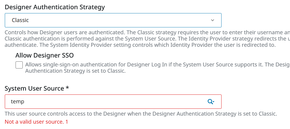

1. Reset password with gwcmd -p
2. Set **Designer Authentication Strategy** to **Identity Provider** (we have SAML)
3. Delete Ignition’s created “temp” source.
4. Change any param in /app/platform/security/settings, such as “Gateway audit profile”.
This is because **Designer Authentication Strategy \>**  **Classic mode** has “temp” user souce selected.
 ![image](https://us1.discourse-cdn.com/inductiveautomation/original/3X/f/9/f93d08e430505304a63fb56291076479ef98f6ba.png)

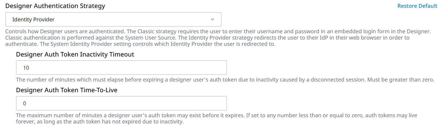

Note that this error appears when having “Identity Provider” mode selected, which does not require that field.
 ![image](https://us1.discourse-cdn.com/inductiveautomation/original/3X/3/a/3abea2ef1dea1f9f1cf36bc6182bbd94193e3ea0.png)

**Author:** ![michael.flagler](https://sea1.discourse-cdn.com/inductiveautomation/user_avatar/forum.inductiveautomation.com/michael.flagler/32/26272_2.png) [@michael.flagler](https://forum.inductiveautomation.com/u/michael.flagler)\
**Post date:** [September 3, 2025, 11:39am UTC](https://forum.inductiveautomation.com/t/ign-14158-bug-in-8-3-with-temp-user-source/110350/2 "2025-09-03T11:39:04Z")
The designer authentication strategy is different than the system user source for editing the gateway configuration. This is not what's used to make gateway configuration changes which is what you're trying to do.
The real bug is that it shouldn't let you delete a user source that is still being used.
**Author:** ![diamond](https://avatars.discourse-cdn.com/v4/letter/d/e79b87/32.png) [@diamond](https://forum.inductiveautomation.com/u/diamond)\
**Post date:** [September 3, 2025, 11:52am UTC](https://forum.inductiveautomation.com/t/ign-14158-bug-in-8-3-with-temp-user-source/110350/3 "2025-09-03T11:52:37Z")
Yes, it’s an option too. A warning is displayed but its not very explainatory.

There are only two bugs I see in this scenario:
1. There is no UI indication that a component is failing validation checks when the field is not displayed due to being unused. I’ll open a new ticket to get this fixed, though there’s no chance of it making the 8.3.0 release.
2. the trailing ` 1` at the end of the validation warning/error. I’d actually encountered that earlier today and have already opened that ticket - though it’s an extremely low priority.
