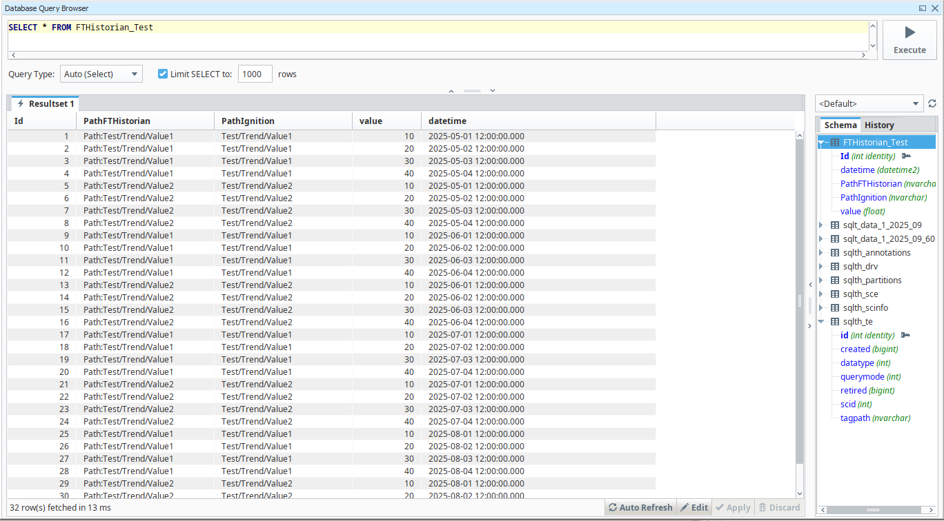

I have a test table that contains the Ignition path, the value, and the timestamp.
When I start my project, some entries are correctly inserted into the historian (tags at ID 1 and 2).

I’m also attaching screenshots of my `sqlth_te` table and my test source table (right now I’m only inserting test values, not the real ones).

Yes, my table FTHistorian\_Test is queried in ascending order before inserting the entries, using this named query:
```python
SELECT *
FROM FTHistorian_Test
WHERE PathFTHistorian in ({PathFTHistorian})
order by PathFTHistorian asc,datetime asc
