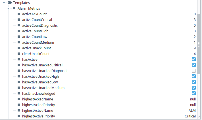

Hi Garth,
Thanks for your response. I'm actually exhibiting some other odd behaviors related to alarms.
I've got several test alarms in my dev environment and none appear to be populating the alarm status table. This is after dragging and dropping a fresh alarm status table on to a window.
Is there something else I am missing? Or some diagnostics I could check to see the status of alarms on the gateway webpage?
Edited to add:
The following script ran in the script console is also not seeing any alarms:
```python
# Query Ignition alarms
unacked_alarms = system.alarm.queryStatus(state=["ActiveUnacked","ClearUnacked"])
print("Found '{}' unacknowledged alarms...".format(len(unacked_alarms)))
# For each alarm returned by the query function, pull the ID as a string
for alarm in unacked_alarms:
	event_ID = "%s" % (alarm.getId())
	# Acknowledge the alarm events by their ID
	system.alarm.acknowledge([event_ID],None)
with these alarm metrics:
 ![image](https://us1.discourse-cdn.com/inductiveautomation/original/3X/a/7/a7f8e443805290b73dd849417dac4164bdff2d0b.png)

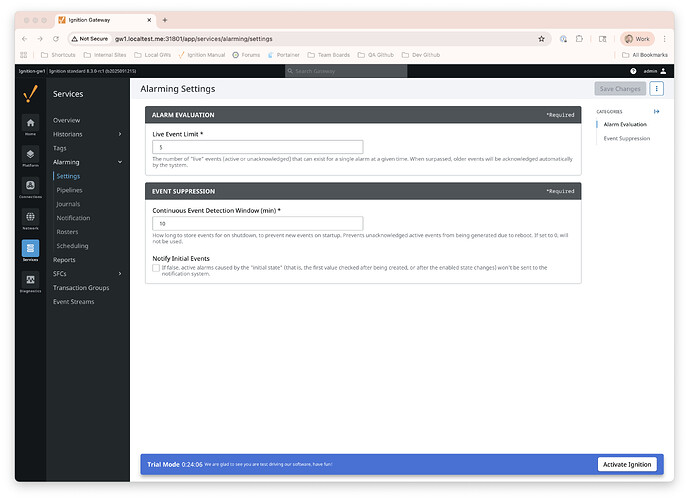

Any chance they are hitting the `Live Event Limit`?
 ![AlarmSettings](https://us1.discourse-cdn.com/inductiveautomation/original/3X/c/a/ca18c640b6e33a698a90f15dce3555b5f388d3ed.jpeg)
Do they populate in the `Alarm Status Table` when showing all the types on the table, e.g. `Show Clear and Acked` isn't enabled by default?

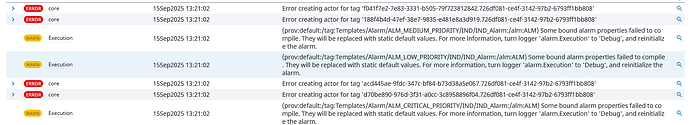

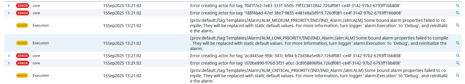

**EDIT:**
Just edited my parent UDT type in the tag browser and saw all of my alarms populate. Not sure what happened. I did remove my ack pipeline but that was the only thing I had changed.
See logs below:
 ![image](https://us1.discourse-cdn.com/inductiveautomation/original/3X/d/8/d869b92aba29ad57c9b1d2cd2a5e9ddea14f2b4c.png)

@Zachary_Ray we have been able to replicate and have opened a ticket for this. We don't know the root cause yet, but I appreciate your help in the replication steps.
Garth
Edit:
The issue looks to be a `displayPath` on the alarm that cannot be compiled (and this looks to be the only property where this issue applies). In 8.3, it is being handled in a manner that is causing the alarm creation to error. As a workaround, changing the definition of the expression binding from:
`{parameter}{TagName}`
to:
`concat({parameter},{TagName})`
would be a solution. It should be noted that even in 8.1 your displayPath would evaluate to `null` but it still allowed the alarm to be created.
We are still evaluating when this will be targeted for a fix.
