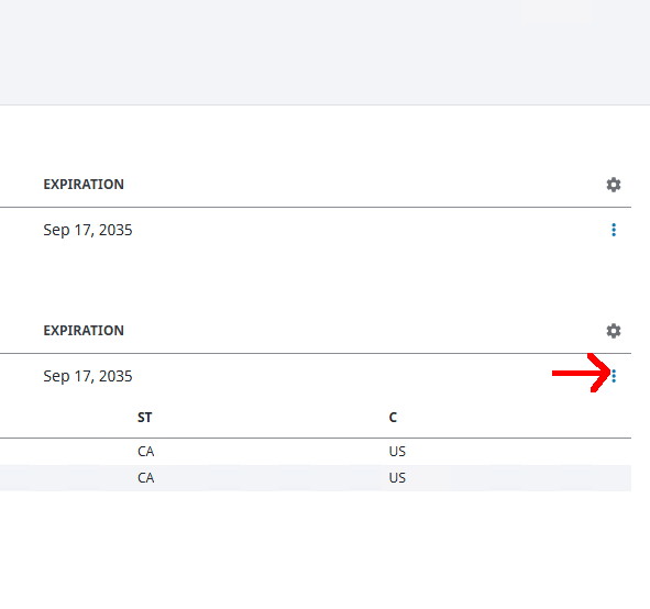

Just installed official release of Ignition v8.3 and I’m trying to set up OPCUA connection with another SCADA software. Is there a way to download OPC-UA server certificate from the gateway page?
In the older version of Ignition (ex. v.8.1.38), there is a ‘Download’ button to download the server certificate (Ignition OPC UA Server). But in v8.3, there is no visible download button.

Anything in the meatball menu on the far right?

Three dots didn’t do anything for me. And the gear icon only shows column visibility options.

You can now use your servers [openapi](http://localhost:8088/openapi) to download the certificate. Specifically, [this one](http://localhost:8088/data/opc-ua/api/v1/server/certificate/download).

While I will get a bug in for not being able to do it from the Certificates tab, Ignition does have to trust it's own certificates. You are able to download the needed certificates from the Client and Server tabs.
