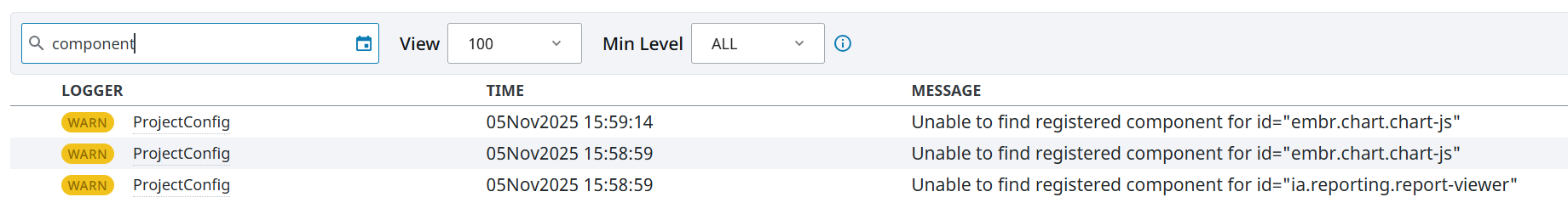

I'm seeing multiple **Unable to find registered component for id = '%module%** errors in my logs, which indicate that some views contain elements from modules that no longer exist. I've been deleting these elements as I go.
However, I'm also getting Embr Charts-related log entries pointing to views that have Embr charts configured, even though the module is installed and exists (version 4.0.0 (b2025103102)).
 ![image](https://us1.discourse-cdn.com/inductiveautomation/original/3X/d/8/d87ef1c7663456d259a1041bf6f323c5d0b69519.png)
For context: I recently migrated to Ignition 8.3.1. During the migration, I deleted the Embr Charts v8.1 module, then reinstalled v8.3 it afterward.
Thoughts? @bmusson

Yeah that’s annoying.
I think everything is working as far as component registration is concerned…

Maybe put your component registration into `setup` instead? The Perspective component 'management' piece is running in the Perspective module's startup, which due to dependency ordering is guaranteed to happen before your module's startup/component registration... but your `setup` should happen before the parent module's `startup`.

Moving the component registration into `setup` produces the same errors... 😕

Hm. Perspective isn't my area, but this seems weird.
I can tell you that Reporting registers its Perspective components in `setup`, but that's the only first party module we have that uses the registry so it's possible something's broken in 8.3.

Yup this is a bug, the same error shows up when using the Report Viewer:

Internal ticket filed - thanks for keeping us honest 😃

Fixed in 8.3.4
