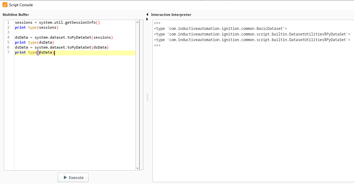

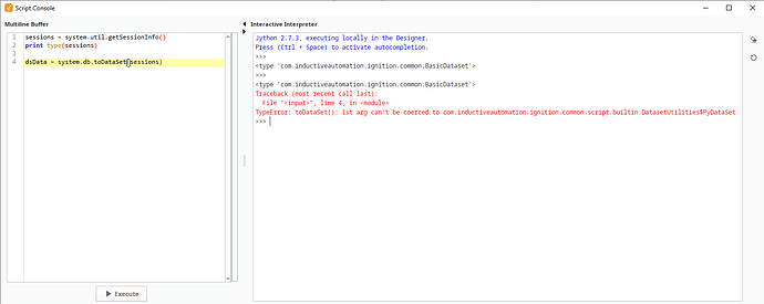

Both the 8.1 and 8.3 manuals intend that this function returns a PyDataSet, however, in 8.3 this function returns a BasicDataSet.
In addition, it appears that you cannot convert a BasicDataSet into a BasicDataSet which throws an error:
 ![image](https://us1.discourse-cdn.com/inductiveautomation/original/3X/a/6/a6619c400a35807ddb0f9d6557132c3e89a2e818.png)
However, you can convert a PyDataSet into a PyDataSet so I’m not sure if this behavior is intended:
 ![image](https://us1.discourse-cdn.com/inductiveautomation/original/3X/8/c/8c42fd14d3fda0283c9ec6bcc4132a824f3011c0.png)

- You cannot convert a BasicDataset into a BasicDataSet
- You can convert a PyDataSet into a PyDataSet

This is a particularly unfortunate edge case.
> [@wingram](#):
> system.db.toDataSet()
If you had been using `system.dataset.toDataSet` this whole time, you would have never noticed. As in, your first test of "wrapping" a DS in a DS _will_ work if you use `system.dataset.toDataSet`.
`system.db.toDataSet` has been deprecated and hidden since **2011** , and is coded (on the Java "backend" side of things) in such a way that it requires you pass in a 'true' `PyDataSet`. `DatasetUtilities`, which is ultimately what `system.dataset` functions call into, would happily accept either type and (not) do the wrapping.
> [@wingram](#):
This is deliberately "supported", but is not actually doing anything; we're detecting that you're trying to 'wrap' and just handing back the original dataset.
The **correct** thing to do in an 8.3+ script is to just ignore the concept of pydatasets completely. Forget they ever existed, remove all operations that wrapped/unwrapped them, and have a happier life.
Understanding that that isn't the most practical on existing large codebases, I'd say that the _easiest_ advice would be to machine edit/find & replace all instances of `system.db.toDataSet` and replace them with `system.dataset.toDataSet`. I'll eventually get this issue fixed first party now that we're aware of it, but prioritization/timing wise the absolute earliest public release you would **potentially** see this in would be mid-February. I doubt you can wait that long.

**Post date:** [December 8, 2025, 6:42pm UTC](https://forum.inductiveautomation.com/t/ign-15067-system-util-getsessioninfo-now-returns-a-basicdataset-breaking-todataset-function-calls/112679/12 "2025-12-08T18:42:16Z")
Thank you paul, I appreciate the quick response! And mid-February is out of the cards so it looks like it’s time for a good ole’ Ctrl + F
