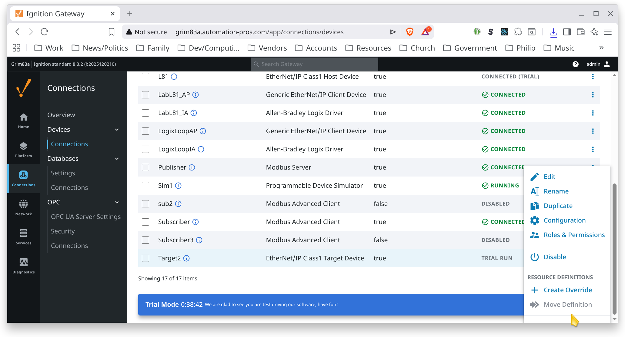

I discovered today that in v8.3.2, if there is a long list of devices, a device close to the bottom margin will have the "Delete" option hidden below the lower edge. ☹
As shown here:
 ![Screenshot_20251216_141922](https://us1.discourse-cdn.com/inductiveautomation/original/3X/9/d/9d19e94d92a50bba7affe9ca84ff338b9d0e980b.png)
~~Might be zoom-related, as I run minimum 150% on this 4K monitor.~~
Nope. I just tried a bunch. The subject device itself doesn't even have to be close to the bottom. If the menu can extend down that far to hide the delete option, it will:
 ![Screenshot_20251216_142846](https://us1.discourse-cdn.com/inductiveautomation/original/3X/3/a/3a75d0aa0077f405239d47c1cc114542406a3a3f.png)

Hey Phil! Thanks for bringing this to our attention. This issue is something we noticed recently and I’ve updated the title with a ticket number. Thanks
**Post date:** [December 16, 2025, 9:30pm UTC](https://forum.inductiveautomation.com/t/ign-15096-device-delete-off-screen/112851/3 "2025-12-16T21:30:02Z")
Excellent. Now I don't need to open a ticket. 😁
A simple work-around is to rename a device to start with `A` or `0` to move it up the page first.
