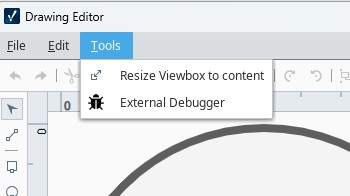

Version 8.3.3
It's only happened twice so far but at some point I lose the ability to select individual objects with the selection tool.
Even when adding a new circle or square it does add it but there's no handles so I can't click or drag anything around the screen. I'm not sure if I'm missing some mode of some kind. I tried closing the views and reopening them but it did the same thing I tried adding a drawing object but it was doing the same thing only after closing Ignition Designer and reopening it did the issue go away.
I wouldn't mind having this handleless mode especially when working in a perspective view. Oftentimes the handles are too big and get in a way when trying to al smaller objects.

Hi, I’d be happy to help diagnose this issue. The next time you’re in this state can you do the following:
- open the dev tools (Tools → External Debbuger)
- also run this command in the console `JSON.stringify(__editorStore._selection)`, and share the results here

That console error is very helpful. I have a hunch of what the issue could be: I think the Drawing Editor is having trouble generating a selection outline for the outline type, causing it to error out after it’s selected.
Would you mind providing the SVG or Drawing Component props (here or in direct message), so I can verify and identity which element type is the cause.

**for visibility:** this particular issue appears to be due to `clip-path`s generated in InkScape not being interpreted correctly by a third party library, throwing an error in the Drawing Editor’s generation of selection outlines. A bug ticket has been made and an equivalent SVG sans the clip-path has been provided.
