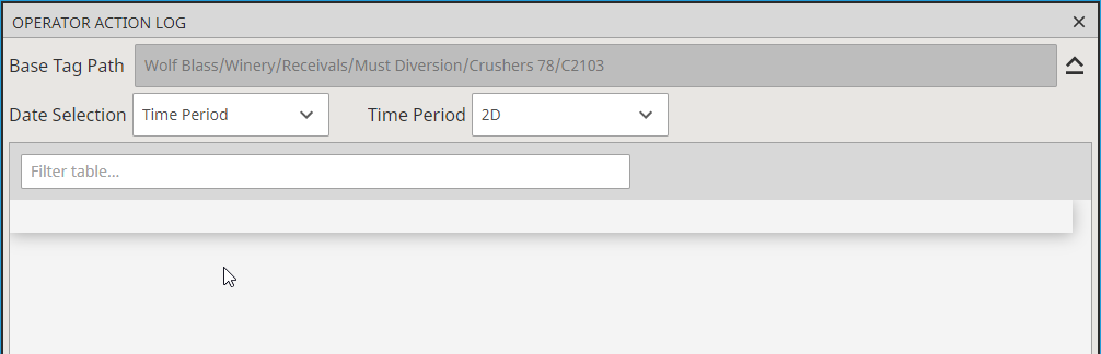

I have a popup to show operation action log entries (i.e. filtered audit log)
 ![image](https://us1.discourse-cdn.com/inductiveautomation/original/3X/9/8/9860290d20be20d9d1784ffd552da98fb41e64fa.png)
The icon on the right of the base tag path (is firstly the wrong icon…) is used to “go up a folder” which removes the last folder from the tag path stored in `params.tagPath`. However when I click on the title of the popup, this param is reset back to its original value.
i.e. if i pass in:
`params.tagPath = 'tag/folder/thing/pump'`
Click on the up folder icon, it will change this to:
`params.tagPath = 'tag/folder/thing'`
Then click on popup title it goes back to:
**Author:** ![cmallonee](https://sea1.discourse-cdn.com/inductiveautomation/user_avatar/forum.inductiveautomation.com/cmallonee/32/6416_2.png) [@cmallonee](https://forum.inductiveautomation.com/u/cmallonee)\
**Post date:** [March 31, 2022, 3:36am UTC](https://forum.inductiveautomation.com/t/ign-5251-clicking-on-popup-title-resets-params-to-those-originally-passed-in/57846/2 "2022-03-31T03:36:48Z")
Fixed in 8.1.14.
