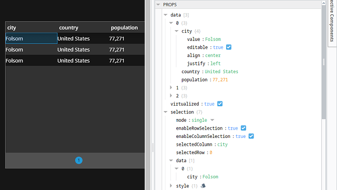

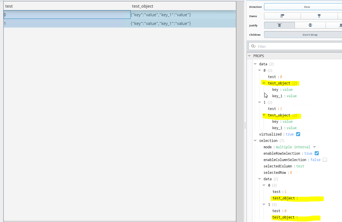

With a perspective table, when items in props.data have objects, they do not show up in the props.selection.data.

I have confirmed this.
What are you trying to achieve by having objects in the cell?

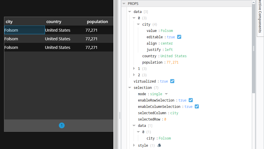

I actually think this would be the expected behavior. This component seems to be designed to look for a specific object structure when you are not providing a direct link to data. If you want each cell to be its own object, the table will automatically recognize certain keys (e.g. value, style, etc). Adding a “value” key to your cell and you should see that value displayed under the selected data:
 ![image](https://us1.discourse-cdn.com/inductiveautomation/original/3X/b/a/ba0f9ab9845c15cdaf2a4401231147eb0f1c9de6.png)
If you really need to reference the entire object of any selected cell, you would probably be better off doing an expression based off the selectedRow and selectedColumn properties.
