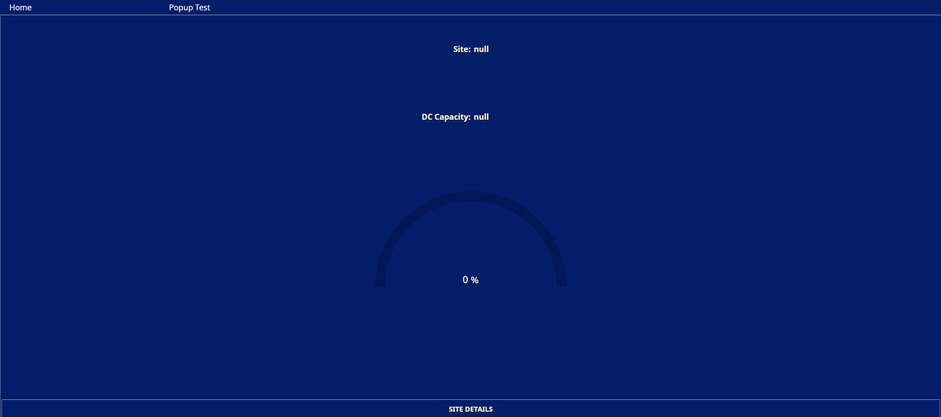

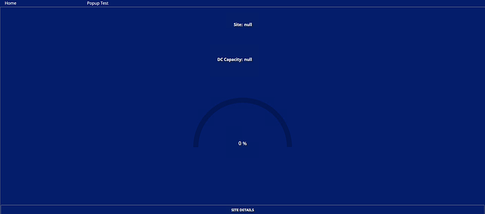

Hello all,
I'm using the perspective map component to show site locations, with a popup displaying KPI details for the site when the marker is clicked.
The issue I'm having is with any scripts firing from the map popup itself. Events seem to trigger correctly when running the embedded view itself in a test page I set up, but nothing happens when the view is in the map marker popup.
I tried sort of backdooring with a boolean on a custom property and a tag change script but that didn't work either. Is this something that just doesn't work with the map component's popups?
**Author:** ![cmallonee](https://sea1.discourse-cdn.com/inductiveautomation/user_avatar/forum.inductiveautomation.com/cmallonee/32/6416_2.png) [@cmallonee](https://forum.inductiveautomation.com/u/cmallonee)\
**Post date:** [November 29, 2022, 8:08pm UTC](https://forum.inductiveautomation.com/t/ign-6877-how-to-trigger-scripts-from-perspective-map-popups/67051/2 "2022-11-29T20:08:24Z")
We can't help with scripts unless you supply the script that is having an issue. There's no reason a script should work in the Designer but not a Client - even in the Map popup.
**Author:** ![Jacob\_Barlow](https://avatars.discourse-cdn.com/v4/letter/j/e99b99/32.png) [@Jacob\_Barlow](https://forum.inductiveautomation.com/u/Jacob_Barlow)\
**Post date:** [November 29, 2022, 8:13pm UTC](https://forum.inductiveautomation.com/t/ign-6877-how-to-trigger-scripts-from-perspective-map-popups/67051/3 "2022-11-29T20:13:04Z")
I made the script as simple as possible for testing purposes, not passing any parameters, etc.
The site details button fires this event script on mouse down:
 ![image](https://us1.discourse-cdn.com/inductiveautomation/original/3X/7/d/7df02b23043359dba13980d199b479864948a26f.png)
 ![image](https://us1.discourse-cdn.com/inductiveautomation/original/3X/9/0/90b4cbbc37408ebd54c035da9a78cb8089d1c6b0.png)
When the button is pressed from a test page I created for the view everything works as expected, but nothing happens when I click the same button from the map popup:
 ![image](https://us1.discourse-cdn.com/inductiveautomation/original/3X/4/1/412ae534a4f47b40ecd26994fc3278c5b238bc6f.png)

 ![image](https://us1.discourse-cdn.com/inductiveautomation/original/3X/4/9/49f7f0a8d4f8b0d0b1e96d666ccc658a1c820264.png)

Thanks for bringing this issue to our attention. We have since reproduced the issue and a bug has been created.

As a workaround can you change from an onMouseDown event to an actionPerformed event on the button. I tested that locally and works as expected.
