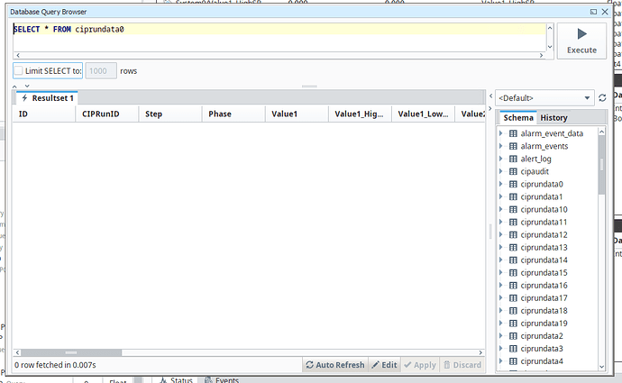

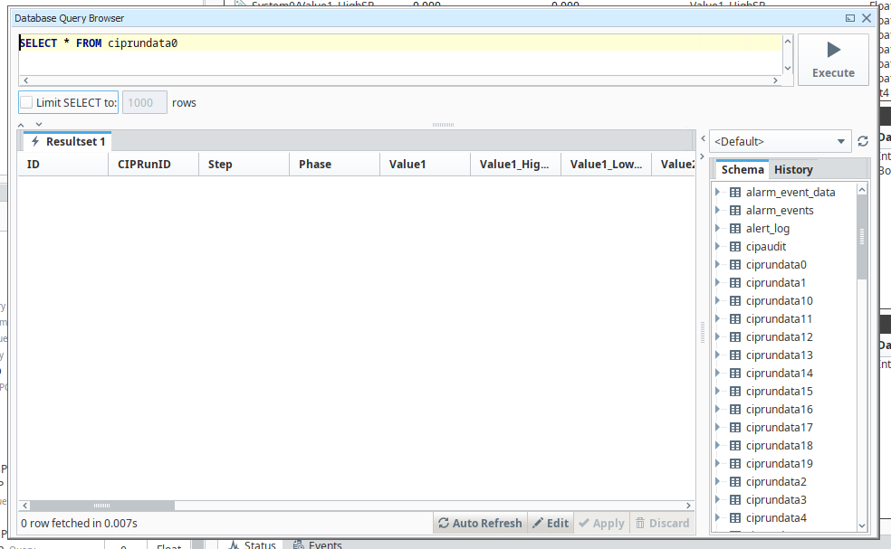

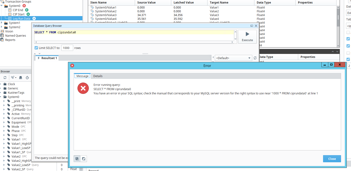

Having an issue with a project upgraded from V7.9 to V8.0 and using MySQL8.0
Transaction groups fail with syntax error and even the database browser has issues.
Anyone seen this ?

**Post date:** [October 22, 2020, 1:21pm UTC](https://forum.inductiveautomation.com/t/ignition-8-0-16-and-mysql8-0/39914/2 "2020-10-22T13:21:30Z")
Does it work if you uncheck that limit box (and maybe add your own to the end of the query)?
What version is the JDBC driver you have installed?

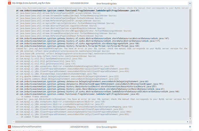

**Author:** ![Curlyandshemp](https://avatars.discourse-cdn.com/v4/letter/c/bcef8e/32.png) [@Curlyandshemp](https://forum.inductiveautomation.com/u/Curlyandshemp)\
**Post date:** [October 22, 2020, 1:24pm UTC](https://forum.inductiveautomation.com/t/ignition-8-0-16-and-mysql8-0/39914/3 "2020-10-22T13:24:39Z")
yes it works if Select is unchecked, no data in table, but at least column names show up.
But main issue is historical transaction groups fail on a syntax error
**Post date:** [October 22, 2020, 1:45pm UTC](https://forum.inductiveautomation.com/t/ignition-8-0-16-and-mysql8-0/39914/6 "2020-10-22T13:45:59Z")
Found my issue.
The MySQL translator was set to MSSQL.
this application was moved from a MSSQL install to a MySQL install.
