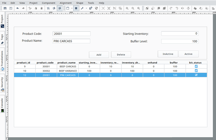

How can i insert color (example color red) from the row when the onhand quantity is less than or equal to the buffer level.
Please see reference:

If your table is a Power Table then the code below should work:
Extension Function - **ConfigureCell**
```auto
	color = system.gui.color('red')
	rows_to_color = [x for x in range(self.data.rowCount) if self.data.getValueAt(x, 6) <= self.data.getValueAt(x, 7)]
	for x in rows_to_color:
		if rowIndex == x:
			return {'background':color}
**Author:** ![vincent.canda](https://avatars.discourse-cdn.com/v4/letter/v/7993a0/32.png) [@vincent.canda](https://forum.inductiveautomation.com/u/vincent.canda)\
**Post date:** [September 18, 2020, 8:20am UTC](https://forum.inductiveautomation.com/t/ignition-8-0-insert-color-from-the-table-row/38819/3 "2020-09-18T08:20:55Z")
Thank you sir. Got it 👌 👌

Is it possible sir to highlight (red) only the onhand column only? not the whole row?
	if rowIndex == x and colIndex == 6:
