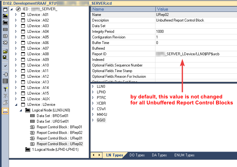

**Post date:** [August 12, 2025, 2:36am UTC](https://forum.inductiveautomation.com/t/ignition-8-1-28-61850-driver-defaults-to-report-4-brcba04/78690/7 "2025-08-12T02:36:50Z")
Seconding Kevin’s response about confirming the Report ID’s.
When you create new report control blocks within Brodersen RTU32, it will increment the Report name, However the auto-generated report ID is the same for all unbuffered report control blocks - I wouldn’t be suprised if other OEM’s had similar quirks.
Created exactly the same issues as above.
