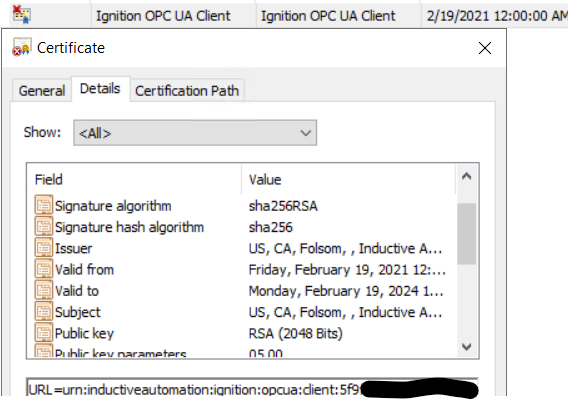

**Author:** ![mlangevin](https://avatars.discourse-cdn.com/v4/letter/m/ce73a5/32.png) [@mlangevin](https://forum.inductiveautomation.com/u/mlangevin)\
**Post date:** [November 19, 2025, 4:34pm UTC](https://forum.inductiveautomation.com/t/ignition-8-1-34-conn-to-wagopfc-bad-certificateusenotallowed-can-connect-via-uaexpert/112274/5 "2025-11-19T16:34:40Z")
Thanks for the responses all.
Here is the trusted ignition OCP UA client cert:
 ![image](https://us1.discourse-cdn.com/inductiveautomation/original/3X/2/8/2841eaa93c30324ac7d90c6a68ee2423816604dd.png)
But in Quarantined, this is still coming up:
 ![image](https://us1.discourse-cdn.com/inductiveautomation/original/3X/b/c/bcca6ac543feb1f4776ab04f8362e038b081355c.png)
There is only one ignition instance, so its interesting that the client URL is different.
But I do agree that (4) is most likely as keysign seems to be the main issue here. Errors on the OPC server side are:
![image](https://us1.discourse-cdn.com/inductiveautomation/original/3X/9/0/90af3c33c860a299257f2c96aec5a2e654ebb619.png)
**Author:** ![Cody\_Morgan](https://avatars.discourse-cdn.com/v4/letter/c/db5fbb/32.png) [@Cody\_Morgan](https://forum.inductiveautomation.com/u/Cody_Morgan)\
**Post date:** [November 19, 2025, 4:48pm UTC](https://forum.inductiveautomation.com/t/ignition-8-1-34-conn-to-wagopfc-bad-certificateusenotallowed-can-connect-via-uaexpert/112274/6 "2025-11-19T16:48:32Z")
That is weird. When I regenerate my Ignition OPC UA client certificate, the URL is the same.
 ![image](https://us1.discourse-cdn.com/inductiveautomation/original/3X/3/0/3018180d9690626185dd22d01f8ee6d3ec018b89.png)
Maybe it's just a weird red herring, I'm not familiar enough to say. But, I would only expect different URLs for different clients. You are grabbing both of these certificates from the WAGO OPC UA server, right? Have you tried comparing them with the certificate on the gateway:
 ![image](https://us1.discourse-cdn.com/inductiveautomation/original/3X/6/1/614913418e3245bcb28fe252d3909ddbd1b8060a.png)
