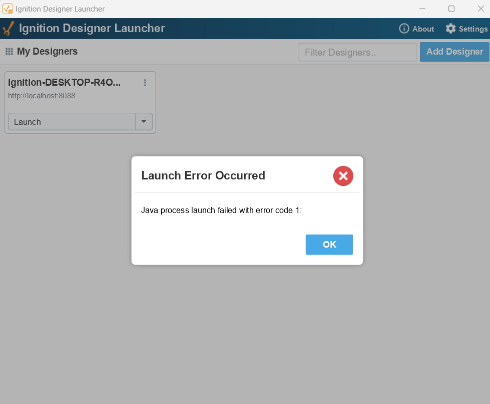

After installing 8.1.5 I’m seeing this when opening vision client or designer.
Please advise.

I managed to fix this by deleting the “cache” file in the “.igntion” folder. After that both designer and client launchers worked again.
**Post date:** [May 11, 2021, 2:16pm UTC](https://forum.inductiveautomation.com/t/ignition-8-1-5-java-process-launch-failed-with-error-code-1/46560/3 "2021-05-11T14:16:17Z")
When this happens deleting the runtime folder should work (`runtimes/11.0.10` or whatever the version is).
We’re aware of this issue but I’m not sure there’s any definitive cause or fix yet. It only happens to Windows users and may have something to do with AV software interfering when the runtime gets unzipped.

See path in screenshot in initial post and change username to the username you are running under, something like this, substituting version number in your error message for ##.#.## below:
`C:\Users\YOUR_USERNAME\.ignition\cache\resources\runtimes\##.#.##`

When the designer fails to launch, you usually have to look in the launcher's log file to obtain the actual designer java execution attempt's command line, and run that in a terminal. Running in a terminal shows all of that attempt's debugging information, which you would share here if it doesn't indicate a problem you know how to fix.

**Post date:** [March 26, 2025, 10:42am UTC](https://forum.inductiveautomation.com/t/ignition-8-1-5-java-process-launch-failed-with-error-code-1/46560/17 "2025-03-26T10:42:57Z")
Copy and paste the long command on the line the starts with "Starting Java with the following parameters: " and paste that into a command prompt and run it.
