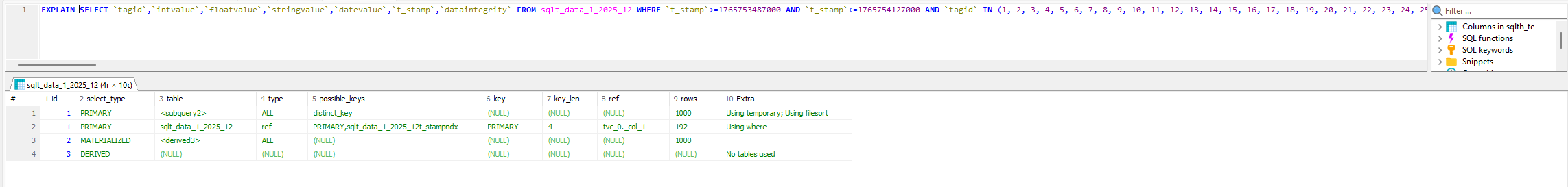

**Author:** ![robert.t](https://avatars.discourse-cdn.com/v4/letter/r/a183cd/32.png) [@robert.t](https://forum.inductiveautomation.com/u/robert.t)\
**Post date:** [December 16, 2025, 9:55pm UTC](https://forum.inductiveautomation.com/t/ignition-8-3-2-queryhistory-latency/112778/11 "2025-12-16T21:55:52Z")
For the `EXPLAIN SELECT tagid…` I have got the following result:
 ![image](https://us1.discourse-cdn.com/inductiveautomation/original/3X/1/b/1b7e9c7bc1aeee303da158b02733424e16cae4fe.png)
**Post date:** [December 16, 2025, 10:00pm UTC](https://forum.inductiveautomation.com/t/ignition-8-3-2-queryhistory-latency/112778/12 "2025-12-16T22:00:25Z")
That first step looks wrong. Should be an index scan or the MariaDB equivalent. That it uses a temporary table suggests that is the culprit.
Consider adding a new index on `(t_stamp, tagid)` and seeing if your query will use it.
**Post date:** [December 16, 2025, 10:05pm UTC](https://forum.inductiveautomation.com/t/ignition-8-3-2-queryhistory-latency/112778/13 "2025-12-16T22:05:56Z")
I see. I will try what you suggested for the new index.
@mazeyrat
The max\_allowed\_packet is currently the default = 16777216
**Post date:** [December 16, 2025, 11:13pm UTC](https://forum.inductiveautomation.com/t/ignition-8-3-2-queryhistory-latency/112778/14 "2025-12-16T23:13:22Z")
After updating my index to be `PRIMARY_KEY(t_stamp, tagid)` like this:
 ![image](https://us1.discourse-cdn.com/inductiveautomation/original/3X/2/b/2b5d76942506e467cec89a91dfc705c4d09cf093.png)
The `EXPLAIN SELECT ...` result now looks like this:
 ![image](https://us1.discourse-cdn.com/inductiveautomation/original/3X/a/3/a329087de1c623e0cc2386465a2812d89b43c86c.png)
The rows that had the `Using temporary; Using filesort` is no longer there and the response time has improved.
I will run some more tests to make sure I have not missed anything, but this does appear to have solved the issue that I was having.
Thank you @pturmel and @mazeyrat for the help and suggestions.
