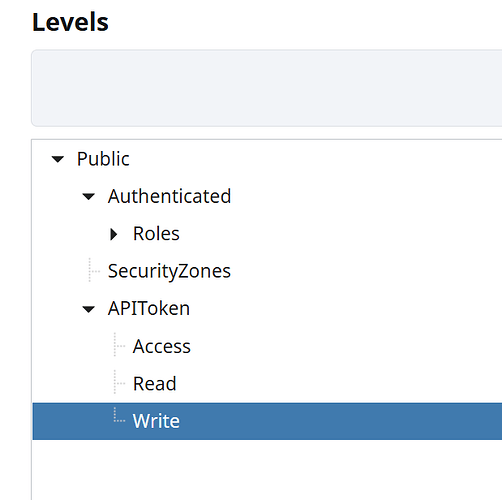

1. Under `Platform > Security > Levels`, ensure that a write-level Security Level has been created. Access and read permission levels may also be desired and configured at this time. Example of what that would look like:
 ![image](https://us1.discourse-cdn.com/inductiveautomation/original/3X/a/0/a0fd33a76a5c31d13c97a19125a1dc90dc5d0d57.png)

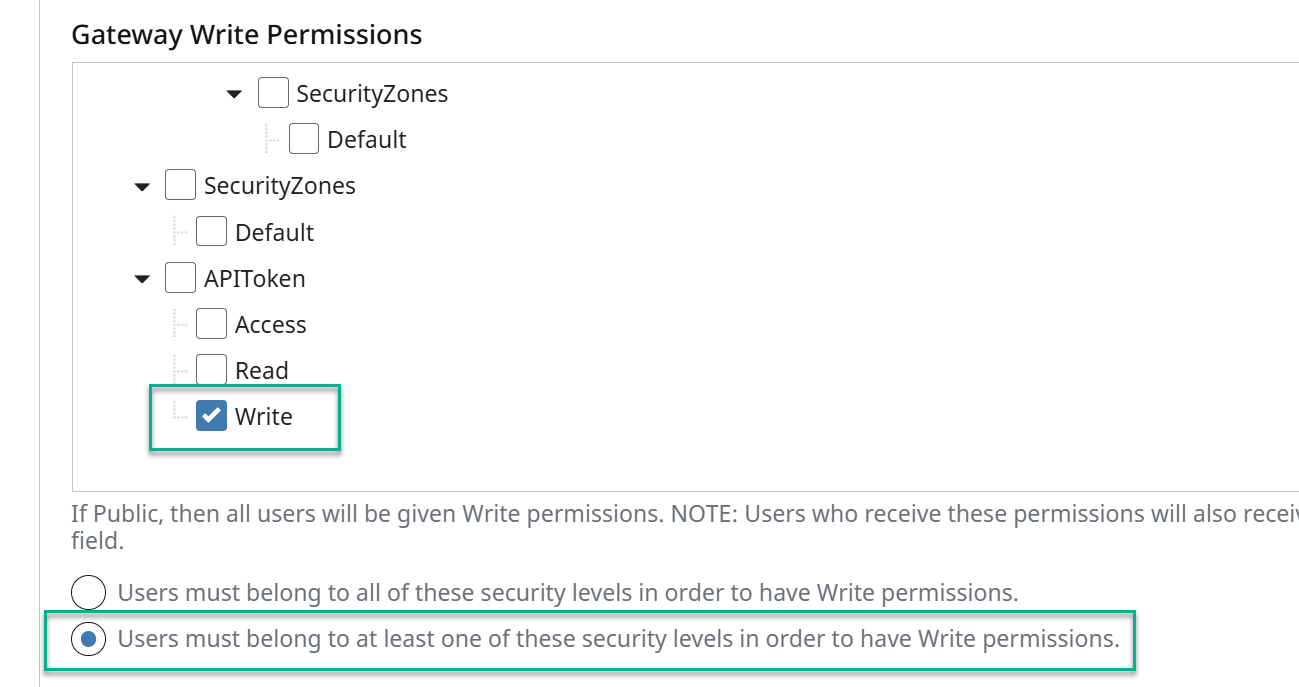

1. In `Platform > Security > General Settings`, assign the write-level Security Level to `Gateway Write Permissions` and choose the "AnyOf" option (unless intent is otherwise):

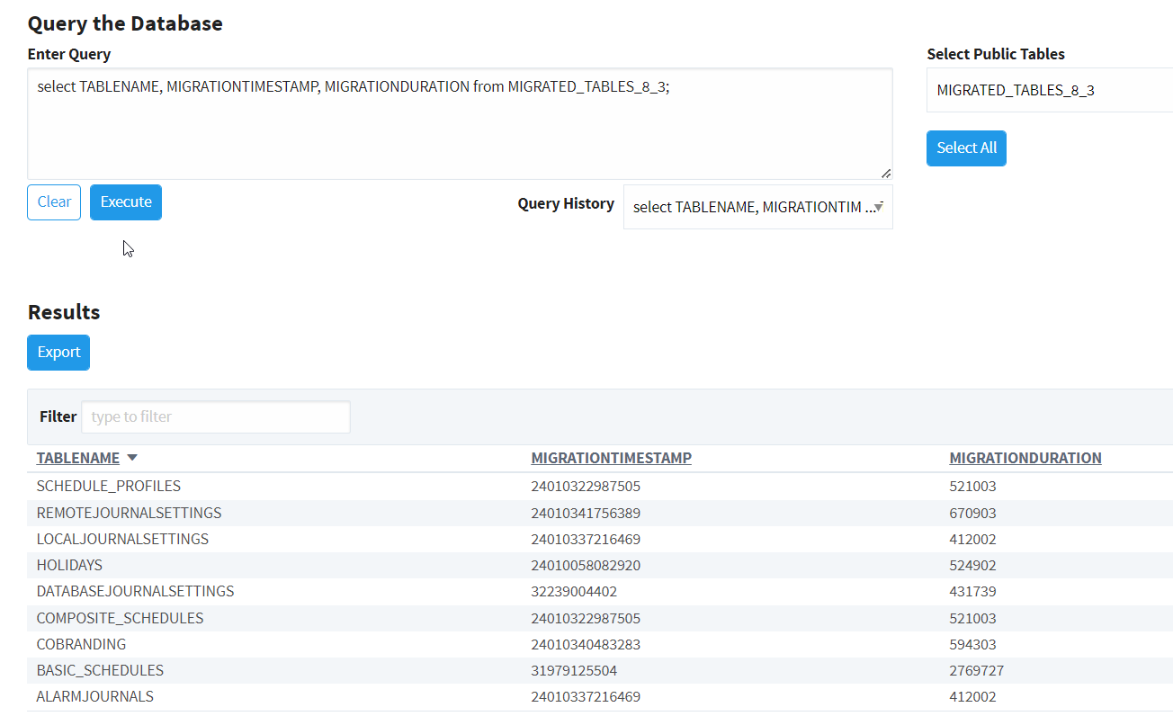

The migration process takes place at the beginning of each gateway startup. The gateway will look for any tables in the Internal IDB that have a migration strategy implemented and performs a migration of the configuration found in the applicable table into resource files which are stored in the `data/config/resources/core` directory within their respective resource type folders. Once this migration has been completed, the IDB table name is added to the MIGRATED\_TABLES\_8\_3 IDB table for record keeping so that the migration does not have to be performed again during the next gateway startup.
 ![](https://us1.discourse-cdn.com/inductiveautomation/original/3X/6/a/6a27b9e64752efca5d2ec5ebb6786f39c791d178.png)
![](https://us1.discourse-cdn.com/inductiveautomation/optimized/3X/f/c/fc3e6c40181fafed41345e107726cb0f5a7f2aa3_2_624x24.png)
#### Retriggering Migration
Knowing this, it may be useful to retrigger migration for various reasons (eg. to quickly configure config settings in the old system using the existing Wicket pages and triggering migration to bypass the new WebUI 🙂). The procedure to do this is as follows:
1. Delete the desired table(s) from the MIGRATED\_TABLES\_8\_3 IDB table
2. Remove the corresponding resource files from `data/config/resources/core` (because migration will not complete properly/entirely if duplicate resource files are found for a particular resource)
3. Restart the gateway.
Alternatively to simply retrigger migration for all resources:
1. Drop the MIGRATED\_TABLES\_8\_3 IDB table
2. Delete `data/config/resources/core`
3. Restart the gateway. \*\*Important note that any specific resources can be saved prior to deleting core and copied back in post migration if you wish to keep them (good example - `ignition/api-token`).
 ![image](https://us1.discourse-cdn.com/inductiveautomation/original/3X/e/9/e993d1437c6d4e40aeee4ea0bb6bd6991fa7d98e.png)
1. On the API token, assign the Security Level with write access:
 ![image](https://us1.discourse-cdn.com/inductiveautomation/original/3X/2/a/2ad9f845c3a2c8ee37b16ec136a681ff5a86c839.png)
At this point, requests sent using the API token should be properly authorized since write level access has been configured and granted. Please feel free to reach out again if you encounter issues or have any questions.

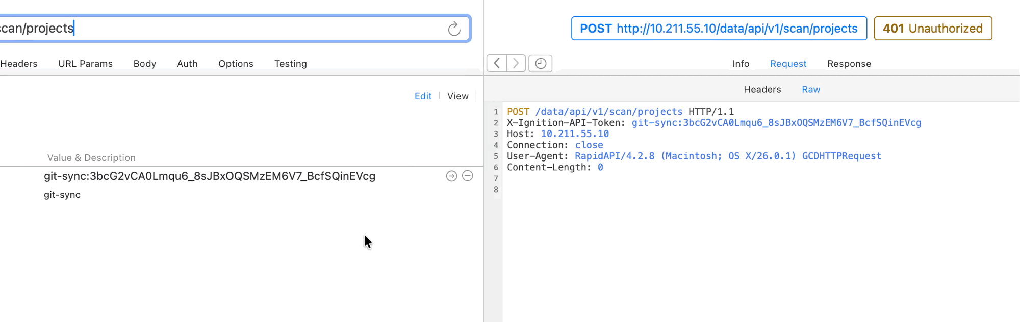

**Author:** ![jfan](https://avatars.discourse-cdn.com/v4/letter/j/e8c25b/32.png) [@jfan](https://forum.inductiveautomation.com/u/jfan)\
**Post date:** [September 29, 2025, 7:27pm UTC](https://forum.inductiveautomation.com/t/ignition-8-3-api-usage-guide-via-postman/93935/9 "2025-09-29T19:27:03Z")
Hi, I followed step by step but getting the authorized error from Postman. Could you point me in the right direction?
```python
<html>
<head>
    <meta http-equiv="Content-Type" content="text/html;charset=ISO-8859-1" />
    <title>Error 401 Unauthorized</title>
</head>
<body>
    <h2>HTTP ERROR 401 Unauthorized</h2>
    <table>
        <tr>
            <th>URI:</th>
            <td>/data/api/v1/scan/config</td>
        </tr>
        <tr>
            <th>STATUS:</th>
            <td>401</td>
        </tr>
        <tr>
            <th>MESSAGE:</th>
            <td>Unauthorized</td>
        </tr>
    </table>
</body>
</html>
**Author:** ![code\_skin](https://avatars.discourse-cdn.com/v4/letter/c/43a26b/32.png) [@code\_skin](https://forum.inductiveautomation.com/u/code_skin)\
**Post date:** [September 29, 2025, 7:30pm UTC](https://forum.inductiveautomation.com/t/ignition-8-3-api-usage-guide-via-postman/93935/10 "2025-09-29T19:30:56Z")
Could you share your setup in detail more? “authorized error from Postman” is quite vague.
For starters, do you have your generated API token pasted into postman (via the url or environments files)?

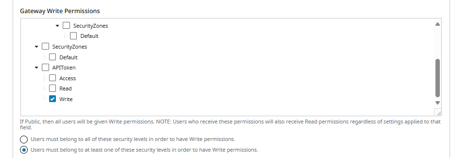

**Post date:** [September 29, 2025, 7:40pm UTC](https://forum.inductiveautomation.com/t/ignition-8-3-api-usage-guide-via-postman/93935/14 "2025-09-29T19:40:16Z")
security levels were setup as well.

**Author:** ![hunterdg](https://sea1.discourse-cdn.com/inductiveautomation/user_avatar/forum.inductiveautomation.com/hunterdg/32/67774_2.png) [@hunterdg](https://forum.inductiveautomation.com/u/hunterdg)\
**Post date:** [October 24, 2025, 11:57pm UTC](https://forum.inductiveautomation.com/t/ignition-8-3-api-usage-guide-via-postman/93935/17 "2025-10-24T23:57:37Z")
any idea why modifying the last letter of my API key still returns 200 instead of 401?
![CleanShot 2025-10-24 at 18.55.45](https://us1.discourse-cdn.com/inductiveautomation/original/3X/0/b/0b44aacc517da1b0e771aa3a547b90ccc2722f8a.gif)
**Post date:** [October 25, 2025, 12:00am UTC](https://forum.inductiveautomation.com/t/ignition-8-3-api-usage-guide-via-postman/93935/18 "2025-10-25T00:00:48Z")
The API token isn't provided as a URL parameter... it's provided in an `X-Ignition-API-Token` header.
**Post date:** [October 25, 2025, 12:05am UTC](https://forum.inductiveautomation.com/t/ignition-8-3-api-usage-guide-via-postman/93935/19 "2025-10-25T00:05:50Z")
right 😉 here’s one with header
![CleanShot 2025-10-24 at 19.04.24](https://us1.discourse-cdn.com/inductiveautomation/original/3X/b/0/b049df635ca3140cd6f3f3cc79fdef499024ea50.gif)
**Post date:** [October 25, 2025, 12:13am UTC](https://forum.inductiveautomation.com/t/ignition-8-3-api-usage-guide-via-postman/93935/20 "2025-10-25T00:13:09Z")
I _think_ this may have something to do with extra bits in base64 encode/decode, but I'll poke around to make sure.
**Post date:** [October 25, 2025, 12:19am UTC](https://forum.inductiveautomation.com/t/ignition-8-3-api-usage-guide-via-postman/93935/21 "2025-10-25T00:19:26Z")
**Post date:** [October 25, 2025, 12:22am UTC](https://forum.inductiveautomation.com/t/ignition-8-3-api-usage-guide-via-postman/93935/22 "2025-10-25T00:22:05Z")
Guess I should’ve thought for a moment. I lazily tried to purposefully bork a test and kept getting success. Thanks.
**Post date:** [October 25, 2025, 12:22am UTC](https://forum.inductiveautomation.com/t/ignition-8-3-api-usage-guide-via-postman/93935/23 "2025-10-25T00:22:20Z")
Change a few more letters and I think you'll get the failure you're after.
