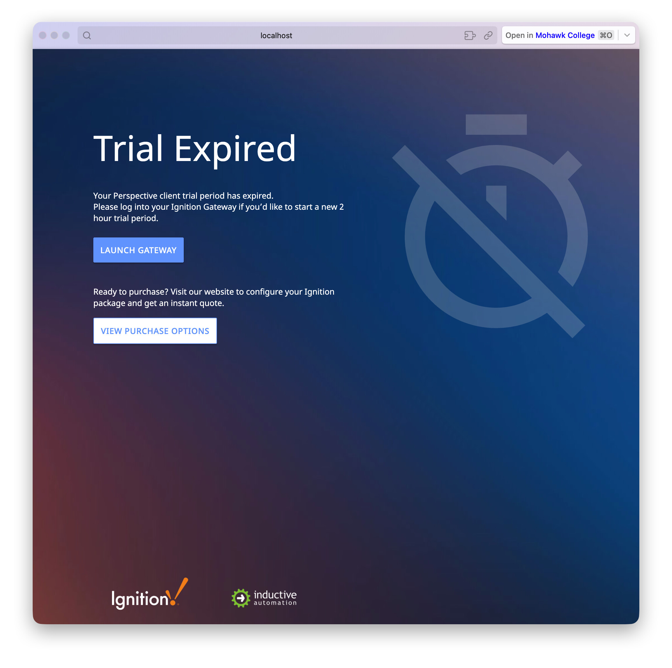

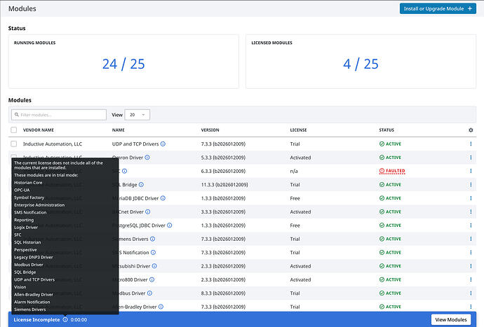

Hello,
I have recently upgraded from Ignition 8.1 to 8.3.3. However, I am now facing some licensing issues, I figured that when was trying to open the Perspective Workstation and was told “trial expired“ (refer to the screenshot 1). Screenshots 2 and 3 demonstrate the module statuses and current licenses.
I have tried restarting the gateway and it did not help.
Thanks in advance.
 ![image](https://us1.discourse-cdn.com/inductiveautomation/original/3X/e/7/e7ef3efa3387f981aa4dd6105a89c266a8a2b2bb.jpeg)
 ![image](https://us1.discourse-cdn.com/inductiveautomation/original/3X/a/9/a9ba50d5f7704ecda7d5eb8ec5b9ab7c5e42d3ec.jpeg)
 ![image](https://us1.discourse-cdn.com/inductiveautomation/original/3X/f/e/fe82142358903ac8d108ee08efc1c3d0fd87532a.png)
**Post date:** [February 10, 2026, 2:58pm UTC](https://forum.inductiveautomation.com/t/ignition-8-3-licensing-issues/113871/2 "2026-02-10T14:58:16Z")
v8.1 licenses don't work in v8.3. Did you contact IA sales to upgrade your license? (If you aren't under a support contract, it isn't free.)
