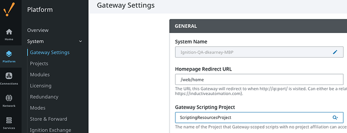

Do you have your Gateway Scripting Project set in the gateway config? And are there any errors in the Designer console?
 ![Screenshot 2025-11-19 at 9.10.12 AM](https://us1.discourse-cdn.com/inductiveautomation/original/3X/a/6/a663c432db656e9b1d3f8b5d56637f65a7fcf2ca.png)
**Author:** ![tjsantos](https://avatars.discourse-cdn.com/v4/letter/t/d78d45/32.png) [@tjsantos](https://forum.inductiveautomation.com/u/tjsantos)\
**Post date:** [November 19, 2025, 2:16pm UTC](https://forum.inductiveautomation.com/t/ignition-8-3-scheduled-scripts-not-showing-in-gateway-or-executing/112269/16 "2025-11-19T14:16:08Z")
I believe it is well configured
 ![image](https://us1.discourse-cdn.com/inductiveautomation/original/3X/2/0/20a40e4e340cb9df0ee1ff1d12a00c6a4f86ab17.png)
**Post date:** [November 19, 2025, 2:19pm UTC](https://forum.inductiveautomation.com/t/ignition-8-3-scheduled-scripts-not-showing-in-gateway-or-executing/112269/17 "2025-11-19T14:19:05Z")
Got what the problem was!
The project was not enabled… strange as it seems…
Thank you all for your time and excuse my “noobiness” ^.^’
