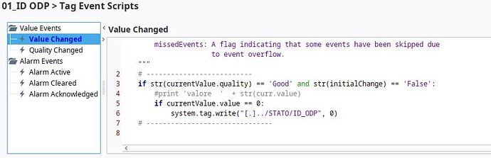

Hi,
I imported a type of data created with Ignition 7.9.10 in Ignition 8, in some tag events some scripts have been included that report the error. Do I need to change something in the path?
Ignition 7.9.10

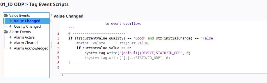

 ![tag_script_01](https://us1.discourse-cdn.com/inductiveautomation/original/2X/c/c8dc7a391b56c6e944e18496cc14c5a6c5d6e58f.jpeg)
Ignition 8 Version: **8.0.1-rc1**
 ![tag_script_02](https://us1.discourse-cdn.com/inductiveautomation/original/2X/7/7b06f6419114006a181d565a1aab1b7efd92d09b.jpeg)

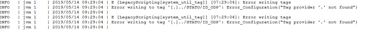

Error to gateway
 ![tag_script_03](https://us1.discourse-cdn.com/inductiveautomation/original/2X/6/6d17dfa95cf9e4ce3ae252350f59b4865340c3ce.jpeg)

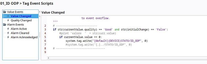

Y have test this, have the same error
 ![tag_script_04](https://us1.discourse-cdn.com/inductiveautomation/original/2X/2/23f961e9aaa9b9d31aaeb33ec1a5a9e3ff51e5b3.jpeg)

Hi,
Insted use [default] try to use [~] also the {DEVICE} is a Parameter?
In the ignition 8 we need to use concat I think to concat values at string.

Yes, {DEVICE} is a Parameter
