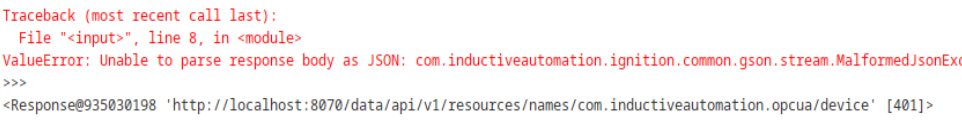

I get the same response 401. It also seems that the .json at the end of response is not liked by the script console.
Here is the code I have:
url = '[http://localhost:8070/data/api/v1/resources/names/com.inductiveautomation.opcua/device](http://localhost:8070/data/api/v1/resources/names/com.inductiveautomation.opcua/device)'
headers = {
'X-Ignition-API-Token': 'Reader:TOKEN HERE',
response = system.net.httpClient.get(url, headers=headers)
print(response)

The 'unable to parse response body as JSON' is because of the 401 error - we return a plain text error that's not valid JSON.

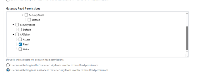

Here is the Security General Settings I have set up:
 ![image](https://us1.discourse-cdn.com/inductiveautomation/original/3X/6/e/6ec8c09e735bc73c03a8f4fb7d690d6b4627f510.png)

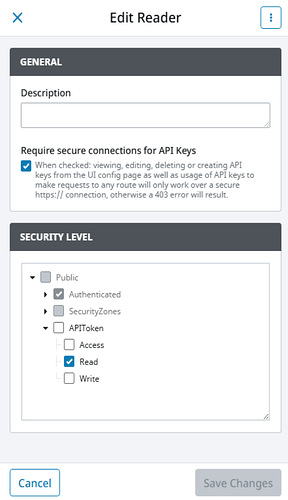

And here is the API Keys setting:
 ![image](https://us1.discourse-cdn.com/inductiveautomation/original/3X/8/b/8b18e96d0e5488f4a4baaa3ccf4ca191239bf5c7.png)
**Post date:** [August 12, 2025, 7:20pm UTC](https://forum.inductiveautomation.com/t/ignition-api-keys/109660/7 "2025-08-12T19:20:38Z")
You have 'require secure connections' set but you're using an HTTP URL.

**Post date:** [August 12, 2025, 7:21pm UTC](https://forum.inductiveautomation.com/t/ignition-api-keys/109660/8 "2025-08-12T19:21:37Z")
It worked!!! Thank You!!!
