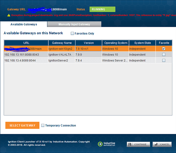

When I run (after setup) the Ignition Client Launcher 7.9.10-rc1 this is what I get:
 ![](https://us1.discourse-cdn.com/inductiveautomation/original/2X/0/0d9678b0fea3fb7dc61d88d2e90ed34559176d2d.PNG)
and here is the log file: [clientlauncher.log](https://us1.discourse-cdn.com/inductiveautomation/original/2X/f/f34b6c543009ae32df1076266beb4b2cd6fa28de.log) (22.2 KB)
Anyone knows what that is?

The problem seems to be this:
```auto
ERROR [SplashFrame] [10:40:38,964]: Exception during project downloads
java.io.IOException: org.xml.sax.SAXParseException; lineNumber: 1; columnNumber: 1027; The reference to entity "F.jpg" must end with the ';' delimiter.

Caused by: org.xml.sax.SAXParseException; lineNumber: 1; columnNumber: 1027; The reference to entity "F.jpg" must end with the ';' delimiter.

Can you share the contents of [http://localhost:8088/system/projectlist](http://localhost:8088/system/projectlist) ?

Ha… when I saw the log file in your replay it hit me:
I had a picture in Ignition image library (which I uploaded) with a ‘&’ sign in the picture name (J&F.jpg)…
I renamed the picture to JF.jpg and now it’s OK.
Yesterday I looked at the log file 10x times and I didn’t see it… 😇
