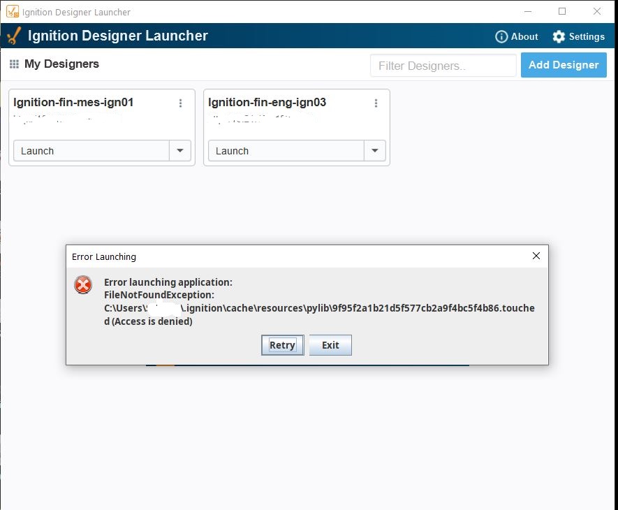

I am unable to launch Ignition Designer and facing the below error:
 ![Captur1e](https://us1.discourse-cdn.com/inductiveautomation/original/2X/b/bee25258ba1ad3ed851d1d2095c48629d4e0b682.jpeg)
I do have my username/password added to User/Roles and have been using for a year, All of a sudden something is broke. Has anyone faced an error like this?
**Post date:** [May 12, 2020, 8:49pm UTC](https://forum.inductiveautomation.com/t/ignition-designer-launch-error/34681/2 "2020-05-12T20:49:57Z")
Try deleting that entire `pylib` folder and then launch the designer again.
**Author:** ![karthikeyyans](https://avatars.discourse-cdn.com/v4/letter/k/d78d45/32.png) [@karthikeyyans](https://forum.inductiveautomation.com/u/karthikeyyans)\
**Post date:** [May 15, 2020, 11:50am UTC](https://forum.inductiveautomation.com/t/ignition-designer-launch-error/34681/3 "2020-05-15T11:50:05Z")
@Kevin.Herron - Recently made a folder level change of viewing hidden files from the folder - Users/xxx/ that gave this error. Reverting my changes back to Hidden solved it.
