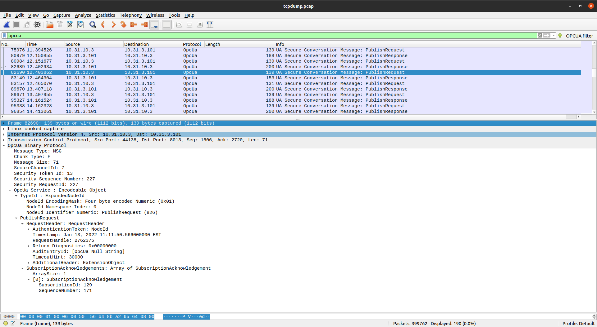

For our application we have a opcua server written with [asyncua](https://github.com/FreeOpcUa/opcua-asyncio). The ignition server is subscribing to a heart beat tag which updated by the asyncua server every second.
On the opcua side, I found that there is one subscription missing acknowledgement. The wireshark shows that subscriptionID 128 is missing acknowledgement.
 ![request_128](https://us1.discourse-cdn.com/inductiveautomation/original/3X/f/e/fe6ba74192067c691c96b5b56b12f5c96ec26282.png)
 ![response_128](https://us1.discourse-cdn.com/inductiveautomation/original/3X/8/1/81028dcc18c4fb22c0b669a2e7206cf490afec79.png)
 ![request_129](https://us1.discourse-cdn.com/inductiveautomation/original/3X/b/5/b52b83e611e2ec99c23a4a609be601f21f92b69a.png)
However if I change the tag’s subscription mode from subscribed to polled and back to subscribed. The asyncua server started to receive proper acknowledgement. Below is the output from asyncua.

**Post date:** [January 21, 2022, 10:01pm UTC](https://forum.inductiveautomation.com/t/ignition-did-not-publish-acknowledgement-for-opc-subscription/55275/2 "2022-01-21T22:01:20Z")
What version of Ignition are you using and is Ignition acting as client or server? You referred to them both as server in your post.
Please upload the captures as well so I don’t have to look at screenshots.

**Post date:** [January 21, 2022, 10:26pm UTC](https://forum.inductiveautomation.com/t/ignition-did-not-publish-acknowledgement-for-opc-subscription/55275/4 "2022-01-21T22:26:54Z")
I’m not sure I understand or see the issue you’re describing.
In the capture you provided all of the PublishResponse messages for SubscriptionId=128 are keep alives (empty notification data). There’s no reason to expect an acknowledge for these.

**Post date:** [January 24, 2022, 2:56pm UTC](https://forum.inductiveautomation.com/t/ignition-did-not-publish-acknowledgement-for-opc-subscription/55275/5 "2022-01-24T14:56:54Z")
Thanks Kevin, but with the same configuration on the ignition after I change the tag’s subscription mode from subscribed to polled and back to subscribed. I have received request with acknowledgement and non empty notification data. I have attached another [dump](https://drive.google.com/file/d/1gr0dQ41eLj_6TURaQh_8zmgft9MWwwiN/view?usp=sharing) for you to compare. Do you know what could cause the difference here?
**Post date:** [January 24, 2022, 3:08pm UTC](https://forum.inductiveautomation.com/t/ignition-did-not-publish-acknowledgement-for-opc-subscription/55275/6 "2022-01-24T15:08:01Z")
Sounds like your server stopped sending change notifications until you forced a new subscription to be made.
