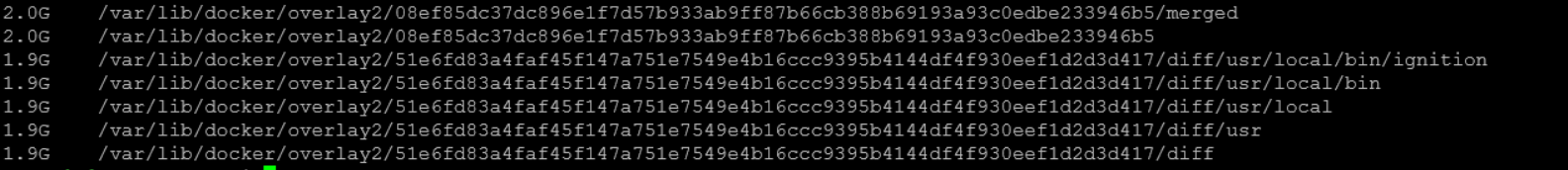

**Author:** ![michel\_feria](https://avatars.discourse-cdn.com/v4/letter/m/ad7895/32.png) [@michel\_feria](https://forum.inductiveautomation.com/u/michel_feria)\
**Post date:** [July 22, 2025, 10:08pm UTC](https://forum.inductiveautomation.com/t/ignition-docker-disk-full-the-disk-that-ignition-is-installed-on-is-nearly-full/88585/12 "2025-07-22T22:08:36Z")
Hello and thanks very much for your prompt reply, it's much appreciated!
so, yes I'm pretty sure that the issue is related to logs as we're using extensively those logs for debug our application 🙂
do you have any idea why the logs are outside the named container? or how to use a bind volume instead of named volume? is that possible?
using du command, I got those files coming from overlay2
 ![image](https://us1.discourse-cdn.com/inductiveautomation/original/3X/e/a/ea21fc235043733e119386c098b81a06c009f69c.png)
thanks again !
kind regards,
**Author:** ![kcollins](https://sea1.discourse-cdn.com/inductiveautomation/user_avatar/forum.inductiveautomation.com/kcollins/32/19646_2.png) [@kcollins](https://forum.inductiveautomation.com/u/kcollins)\
**Post date:** [July 22, 2025, 10:48pm UTC](https://forum.inductiveautomation.com/t/ignition-docker-disk-full-the-disk-that-ignition-is-installed-on-is-nearly-full/88585/13 "2025-07-22T22:48:51Z")
With our Docker image, we currently don't store the wrapper.log within the container, as the logs need to be emitted to stdout for collection by whatever logging driver Docker (or other container runtime) is using. This is to prevent duplicate storage of logs.
The `du` output you posted seems to be from the host--I was originally asking for the output of `du -d 2 -h` from _within_ your Ignition container in order to determine if something there was writing a large volume of data outside of your named volume.
If you're curious about your container logs, those end up under `/var/lib/docker/containers/[container id]/[container id]-json.log` (again, with the default JSON logging driver of a typical Docker Engine installation). It should be pretty obvious if one of those has grown very large. You might be able to truncate them while the container is running, but the best way is to at least stop the container, truncate the log, and start. Ideally, stop Docker Engine altogether, make the changes to `/etc/docker/daemon.json` to enable log file rotation/pruning and then start everything back up. As always, make sure you've got good backups of everything before making changes!

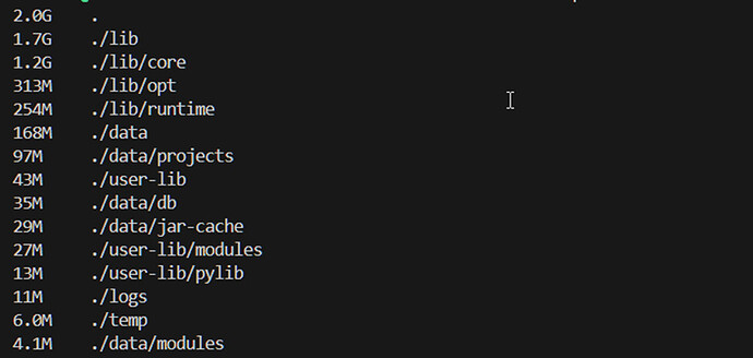

**Post date:** [July 23, 2025, 12:34am UTC](https://forum.inductiveautomation.com/t/ignition-docker-disk-full-the-disk-that-ignition-is-installed-on-is-nearly-full/88585/14 "2025-07-23T00:34:45Z")
> [@kcollins](#):
> `docker exec <container name> du -d 2 -h`
Hi, I ran this command: **docker exec RemoteServer du -d 2 -h | sort -hr**
And I got this:
 ![image](https://us1.discourse-cdn.com/inductiveautomation/original/3X/5/6/565bfc00134277677496492df8279a50eb62486c.jpeg)
I know what I have in the logs as I'm using to debug my functions in the gateway context (the script console is not giving me all that I need) so I know that I'm pouring the log and what I need is to have control on those logs. I cannot acces to any folder below /var/lib/docker so I don't know how to check the json.log on /containers sub-folder.
Last thing, I put your suggested supplemental configuration under /etc/docker/daemon.json and it works as the driver changed from json-file to local but ...inside the gateway setting, I'm seeing the same 50k logs...
what I understand is that the wrapper.log is outside the container, likely in the overlay2 storage, isn't it? so I really need to have access to this wrapper.log to trim it, I will continue to test the log rotation as well,
thanks very much and have a good evening!
MF
**Post date:** [July 23, 2025, 1:59pm UTC](https://forum.inductiveautomation.com/t/ignition-docker-disk-full-the-disk-that-ignition-is-installed-on-is-nearly-full/88585/15 "2025-07-23T13:59:15Z")
> [@michel\_feria](#):
This shows that your disk usage inside the container is very minimal. There are still logs within the `logs/system_logs.idb` SQLite DB that serves the web UI. If you're experiencing locking errors related to this system due to excessive log events, you may need to adjust the log maintenance settings inside `data/logback.xml`--the defaults are in a commented-out block within that file in the event you need to uncomment and adjust those settings. Typically, you might need to increase the `diskspaceCleanupEventCount` setting if the maintenance frequency is unable to keep pace with log growth. All of that said, at `11M`, your logs folder is not very large--I don't think you're having this issue.
Putting this setting into place means that Docker will rotate the container logs (again, to be clear, these are the logs managed by Docker Engine and are not Ignition-specific).
See my previous post on where those logs actually live if you want to inspect--you'll need to escalate to `root` (using sudo, for example) to access the under-hood Docker folders under `/var/lib/docker`. Outside of Docker Engine installs in rootless mode (which isn't the case here as you reference `/var/lib/docker`), if you can manage containers on the host, you have root-level access. Also, to clarify further, there **is no wrapper.log** file in the container and nothing to trim--`/usr/local/bin/ignition/logs/wrapper.log` is a symlink to `/dev/stdout` in our container image and thus emits logs directly to the container runtime (whose log rotation we've already discussed).
