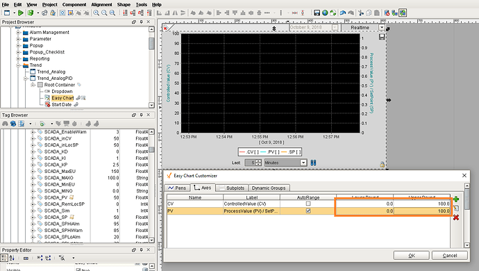

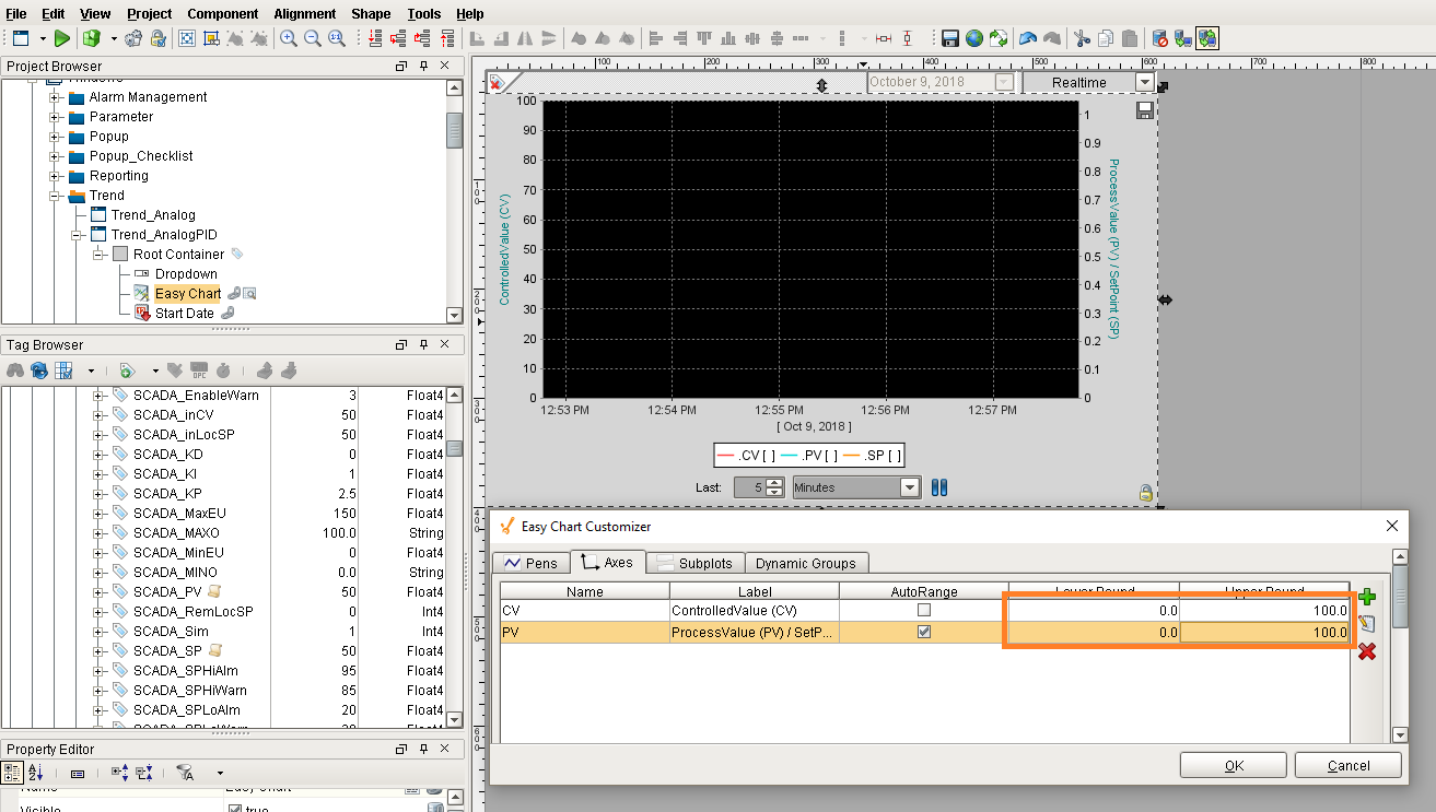

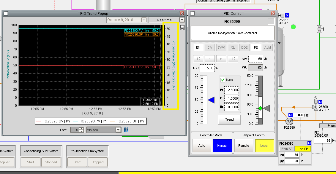

Is there a way to exposed the lower bound & upper bound for the easy chart? This will make it easy to for the user to modify its lower & upper bound on Runtime.

You can bind almost anything on the easy chart using the ‘Cell Update’ binding. Find the ‘Axes’ property in the property editor and click the bindings button.
