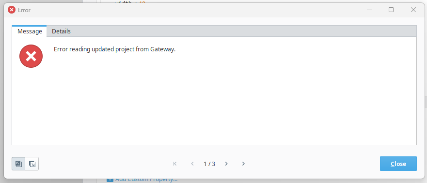

Ignition Edge 8.3.1
@paul-griffith
From Designer, I have often have the following error message:
**com.inductiveautomation.ignition.common.resourcecollection.ResourceCollectionNotFoundException: resource collection not found: resource collection not found: null**
 ![image](https://us1.discourse-cdn.com/inductiveautomation/original/3X/f/6/f6e6a732a5ae8eb0535e3c427db9d44da2608f3b.png)
**Error reading updated project from Gateway.**

Ignition v8.3.1 (b2025102109)
Java: Azul Systems, Inc. 17.0.16
**Post date:** [October 23, 2025, 3:28pm UTC](https://forum.inductiveautomation.com/t/ignition-edge-8-3-1-error-reading-updated-project-from-gateway-resource-collection-not-found-null/111673/2 "2025-10-23T15:28:08Z")
This looks like an issue we're already tracking; hopefully to be fixed in 8.3.2.
To confirm, when this happens if you look on the gateway status page showing designer connections do you suddenly see a lot (7-10) show up? Are you connecting to a redundant pair? Are you using a VPN or similar network intercept software?
**Author:** ![mazeyrat](https://sea1.discourse-cdn.com/inductiveautomation/user_avatar/forum.inductiveautomation.com/mazeyrat/32/10955_2.png) [@mazeyrat](https://forum.inductiveautomation.com/u/mazeyrat)\
**Post date:** [October 23, 2025, 4:25pm UTC](https://forum.inductiveautomation.com/t/ignition-edge-8-3-1-error-reading-updated-project-from-gateway-resource-collection-not-found-null/111673/3 "2025-10-23T16:25:30Z")
I connect on LAN to a redundant edge gateway, without the backup gateway.
I will check this when it occur to confirm
**Post date:** [October 30, 2025, 7:56am UTC](https://forum.inductiveautomation.com/t/ignition-edge-8-3-1-error-reading-updated-project-from-gateway-resource-collection-not-found-null/111673/4 "2025-10-30T07:56:47Z")
log in the designer console:
```python

Okay, this looks like a different way to manifest basically the same issue we're tracking internally. At this point the fix will be no earlier than 8.3.3, unfortunately but it's a high priority issue for us.
**Author:** ![Matjaz\_Furlan](https://avatars.discourse-cdn.com/v4/letter/m/a587f6/32.png) [@Matjaz\_Furlan](https://forum.inductiveautomation.com/u/Matjaz_Furlan)\
**Post date:** [November 6, 2025, 7:28am UTC](https://forum.inductiveautomation.com/t/ignition-edge-8-3-1-error-reading-updated-project-from-gateway-resource-collection-not-found-null/111673/6 "2025-11-06T07:28:44Z")
I have the same issue… So what is workaround till update?? Regards
**Post date:** [November 6, 2025, 12:45pm UTC](https://forum.inductiveautomation.com/t/ignition-edge-8-3-1-error-reading-updated-project-from-gateway-resource-collection-not-found-null/111673/7 "2025-11-06T12:45:25Z")
In such case, I restart the designer
**Post date:** [November 6, 2025, 3:48pm UTC](https://forum.inductiveautomation.com/t/ignition-edge-8-3-1-error-reading-updated-project-from-gateway-resource-collection-not-found-null/111673/8 "2025-11-06T15:48:43Z")
For now, restarting the designer is the only solution.
**Author:** ![cduffy](https://avatars.discourse-cdn.com/v4/letter/c/e480ec/32.png) [@cduffy](https://forum.inductiveautomation.com/u/cduffy)\
**Post date:** [November 14, 2025, 4:30pm UTC](https://forum.inductiveautomation.com/t/ignition-edge-8-3-1-error-reading-updated-project-from-gateway-resource-collection-not-found-null/111673/9 "2025-11-14T16:30:12Z")
8.3 everything worked fine until I changed to redundant backup. I can’t save from designer get the, ResourceCollectionNotFoundException: resource collection not found: resource collection not found: null error. I tried restarting designer, no luck, restarted computer, no luck, In the gateway it shows 2 designer connections, one dormant, both from same PC. The three dots on the right do not work. I’m switching back to independent to make my changes, and then back to redundant.
**Post date:** [November 14, 2025, 4:56pm UTC](https://forum.inductiveautomation.com/t/ignition-edge-8-3-1-error-reading-updated-project-from-gateway-resource-collection-not-found-null/111673/10 "2025-11-14T16:56:03Z")
Redundant backups do not support designer connections. You can only run the designer against the master.
**Post date:** [November 14, 2025, 4:58pm UTC](https://forum.inductiveautomation.com/t/ignition-edge-8-3-1-error-reading-updated-project-from-gateway-resource-collection-not-found-null/111673/11 "2025-11-14T16:58:03Z")
I think they're saying they made their gateway redundant, and the issue started happening (which is what I expect), not that they're actually trying to launch the designer on the backup (which won't work).
It's still a high priority issue that we're planning to get fixed in 8.3.3.
**Post date:** [November 14, 2025, 5:44pm UTC](https://forum.inductiveautomation.com/t/ignition-edge-8-3-1-error-reading-updated-project-from-gateway-resource-collection-not-found-null/111673/12 "2025-11-14T17:44:32Z")
Yes I’m running against the Master.
I switched to Independent and it is working fine. making my changes and saving. When I’m done I’ll switch back to redundant back-up.
**Post date:** [November 25, 2025, 12:56pm UTC](https://forum.inductiveautomation.com/t/ignition-edge-8-3-1-error-reading-updated-project-from-gateway-resource-collection-not-found-null/111673/13 "2025-11-25T12:56:46Z")
Restarting Desginer does not resolve always this problem…
**Author:** ![lizzy.allen](https://avatars.discourse-cdn.com/v4/letter/l/8c91f0/32.png) [@lizzy.allen](https://forum.inductiveautomation.com/u/lizzy.allen)\
**Post date:** [December 3, 2025, 7:11pm UTC](https://forum.inductiveautomation.com/t/ignition-edge-8-3-1-error-reading-updated-project-from-gateway-resource-collection-not-found-null/111673/14 "2025-12-03T19:11:39Z")
I have also found that switching to “ **Independent** ” and making adjustments in the designer then **saving** works. (I also export the project changes for extra measure.)
After I make all the changes I need to and do a final save, I just switch back to “ **Master** ” which has worked fine for updating the gateway with no further issue. However I am looking forward to the fix in the upcoming updates.
**Post date:** [December 16, 2025, 7:08pm UTC](https://forum.inductiveautomation.com/t/ignition-edge-8-3-1-error-reading-updated-project-from-gateway-resource-collection-not-found-null/111673/15 "2025-12-16T19:08:14Z")
any update about the fix in 8.3.3 ?
**Post date:** [December 16, 2025, 10:09pm UTC](https://forum.inductiveautomation.com/t/ignition-edge-8-3-1-error-reading-updated-project-from-gateway-resource-collection-not-found-null/111673/16 "2025-12-16T22:09:26Z")
Probably going to slip to 8.3.4 at this point.
**Post date:** [January 27, 2026, 4:20pm UTC](https://forum.inductiveautomation.com/t/ignition-edge-8-3-1-error-reading-updated-project-from-gateway-resource-collection-not-found-null/111673/17 "2026-01-27T16:20:27Z")
The fix for this issue just got merged in, it'll be available in tomorrow's nightly build and the final release of 8.3.4, which is estimated for release mid February.
**Author:** ![bpomerhn](https://avatars.discourse-cdn.com/v4/letter/b/41988e/32.png) [@bpomerhn](https://forum.inductiveautomation.com/u/bpomerhn)\
**Post date:** [February 20, 2026, 4:26am UTC](https://forum.inductiveautomation.com/t/ignition-edge-8-3-1-error-reading-updated-project-from-gateway-resource-collection-not-found-null/111673/18 "2026-02-20T04:26:19Z")
I am experiencing this problem with all the conditions you listed earlier, redundancy, VPN, multiple sessions showing up. I have to restart the gateways which is kind of unhandy. Killing any designer connections from the gateway doesn’t fix it for me.
Would running a designer in a remote desktop connection on the SCADA server help with this problem?
**Post date:** [February 23, 2026, 4:11pm UTC](https://forum.inductiveautomation.com/t/ignition-edge-8-3-1-error-reading-updated-project-from-gateway-resource-collection-not-found-null/111673/19 "2026-02-23T16:11:29Z")
Not a guarantee. It's a fundamental problem with the session lifecycle and can crop up anytime it's a redundant pair. The 8.3.4 release with the fix got delayed for other issues, but is now projected for early March.
EDIT: 8.3.4 is now available.
