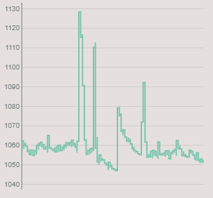

**Author:** ![Chris\_Bingham](https://avatars.discourse-cdn.com/v4/letter/c/e5b9ba/32.png) [@Chris\_Bingham](https://forum.inductiveautomation.com/u/Chris_Bingham)\
**Post date:** [August 2, 2025, 6:38pm UTC](https://forum.inductiveautomation.com/t/ignition-edge-buffer-limitations/109281/8 "2025-08-02T18:38:55Z")
Ahhh, I understand your comment now.
Data is stored FIFO (the oldest data is dropped to store the newest).
Here is a trend from a client who opted for high-res data from an Edge Panel site. Here is a screenshot trending 3 weeks of data **from Edge project** (which is pushed via EAM from full GW):
 ![image](https://us1.discourse-cdn.com/inductiveautomation/original/3X/a/3/a377b765752209b88a48ae3bf94c9dccc40a283f.png)
Note that not a single tag has direct access to history older than approximately 1 week at this site.
And another with the same trend from the full gateway (running the same project, except all queries are executed against the SQL DB when viewed on Full GW):
 ![image](https://us1.discourse-cdn.com/inductiveautomation/original/3X/8/7/8763f97c89ae5112d4b905959764970868d10d72.png)
Using the PowerChart (and all its glory) w/ aggregation (500pt w/ MinMax) - disregard any small changes you might spot on the trends. I assure you that all points on Edge exist in remote DB.
Here are two more, trending only last 10 hrs of data:
Edge:
 ![image](https://us1.discourse-cdn.com/inductiveautomation/original/3X/8/7/87f8a1979fc4a48159d4dc6f031d6a28c057762f.png)
Full:
 ![image](https://us1.discourse-cdn.com/inductiveautomation/original/3X/8/a/8a2d8cf63d0cc1f8bfc495029da0f08d35c27f94.png)
**Post date:** [August 2, 2025, 6:50pm UTC](https://forum.inductiveautomation.com/t/ignition-edge-buffer-limitations/109281/9 "2025-08-02T18:50:31Z")
Ah, good to see. Has the FIFO behavior changed? There were posts some weeks ago where it wasn't FIFO.
**Post date:** [August 2, 2025, 7:07pm UTC](https://forum.inductiveautomation.com/t/ignition-edge-buffer-limitations/109281/10 "2025-08-02T19:07:21Z")
Surprising. I'm unsure of other behaviors. LIFO would be a dealbreaker for me.
