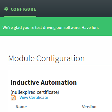

Hello, can anyone help explain why I am seeing this (nullexpired certificate) when I go to Modules under
Configure tab in Ignition Edge?
 ![image](https://us1.discourse-cdn.com/inductiveautomation/original/3X/9/3/9340d016c177c68eed3072c7f698e808f8c98559.png)

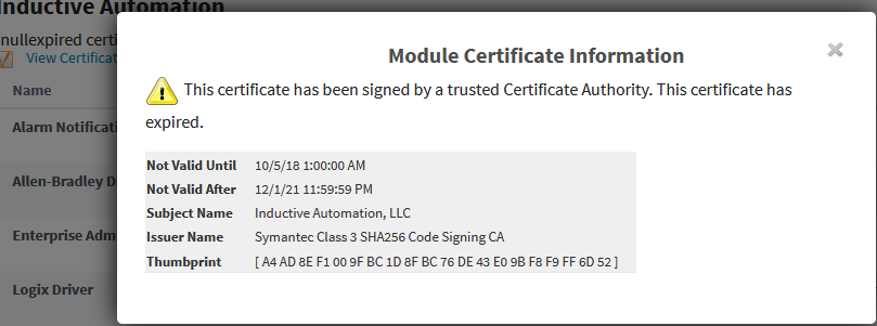

Clicking on the View Certificate I get:
 ![image](https://us1.discourse-cdn.com/inductiveautomation/original/3X/8/2/82cf9f33bc7a1085748c685ac82ff3cb47366c84.png)
So, I see the certificate is NOT valid after Dec 1 2021, but how do I upload a new one?
None of my MQTT Transmission broker connection s are working too, and I guess it’s something to do with this!?!
Ignition Edge v 7.9.18 running on Opto 22EPIC PR1.
**Post date:** [April 10, 2022, 11:14pm UTC](https://forum.inductiveautomation.com/t/ignition-edge-nullexpired-certificate/58264/2 "2022-04-10T23:14:11Z")
7.9.19 should have a new certificate.
You can also just ignore it because these certificates are mostly theatre and don’t mean anything, even when they expire.
