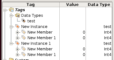

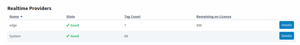

Is there a place to see in the Edge Web page a current tag count… Just wondering how close I am to the 500 limit.
Especially with using DataTypes want to know if each member counts against the tag count.
**Post date:** [October 3, 2017, 8:34pm UTC](https://forum.inductiveautomation.com/t/ignition-edge-tag-count/15555/2 "2017-10-03T20:34:03Z")
Status → Tags has a ‘Remaining on License’ indicator. UDT instances will count towards the ‘Tag Count’ column, but will _not_ reduce the ‘Remaining on License’ value:

- Makes sense that it was on the Status page - not sure why I didn’t check there. Was looking on the Config page under OPC.
Thanks.
