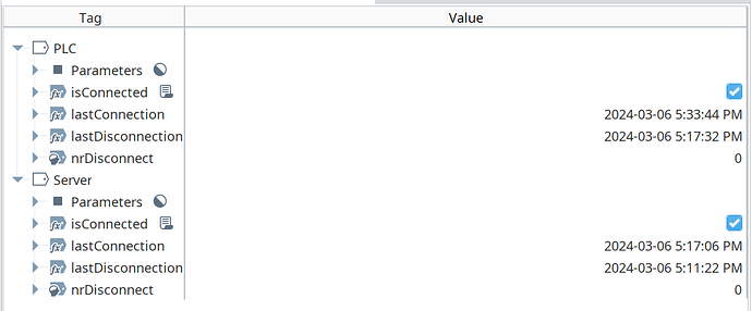

Hi @Aiasa21
 ![image](https://us1.discourse-cdn.com/inductiveautomation/original/3X/1/f/1ff07066c0814a8c54ab24e1e9d5d943bcd8ad82.png)
I've tried to replicate as close as possible your situation.
- Win 19 server in one vlan with ignition 8.1.23
- PLC Compact logix (i don't have a omrom plc) in another Vlan
- Server in the same Vlan as the windows one
It has been running for almost two day and not disconnect count coming. I even tried to do multiple download to the plc to see if that have an impact.
I don't thing this come from the code but more from your config.
Hope this help and don't hesitate if needed or post some feedback if you find something
Regards
**Author:** ![Aiasa21](https://avatars.discourse-cdn.com/v4/letter/a/aeb1de/32.png) [@Aiasa21](https://forum.inductiveautomation.com/u/Aiasa21)\
**Post date:** [March 8, 2024, 8:22am UTC](https://forum.inductiveautomation.com/t/ignition-exchange-network-device-ping-udt-problem/86742/8 "2024-03-08T08:22:41Z")
Hi @Arnaud_Declerck, thank you for your tests.
As you say probably we have something strange on the network that trigger this "fake" errors.
Thanks again, I appreciate you help.
