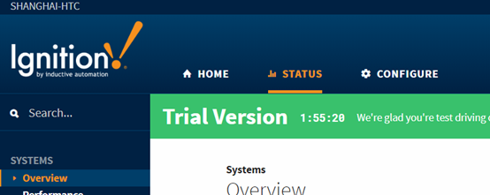

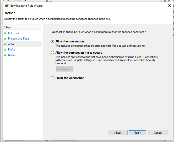

I have installed the 8.0.10rc1 in my PC for demo test, my pc ip address is 192.168.16.87
 ![image](https://us1.discourse-cdn.com/inductiveautomation/original/2X/a/a639583c11f7086cc29e055f7268194ec4ac2ae6.png)
I can open the web-server and gateway in my pc, but can access this server by another PC even the ping is success
 ![image](https://us1.discourse-cdn.com/inductiveautomation/original/2X/6/61fa86e40ce2258082359bbea9a213178bb0a2f2.png)
Here is the picture is another pc can ping access my pc, but the web can’t access.

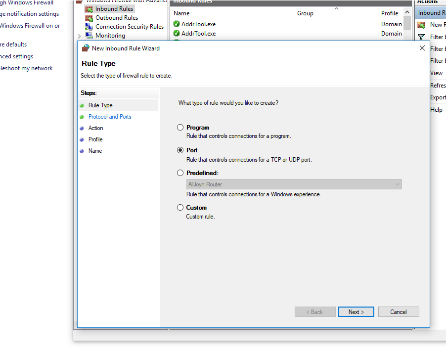

Do you have a firewall (e.g. Windows Firewall) blocking access to port 8088 on the computer that has the gateway installed?

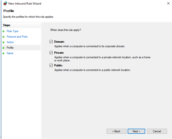

YES, you are right

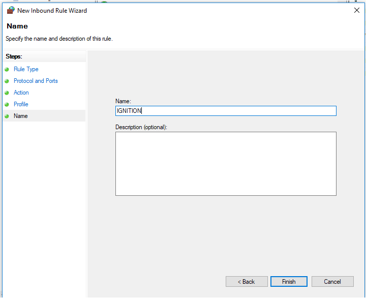

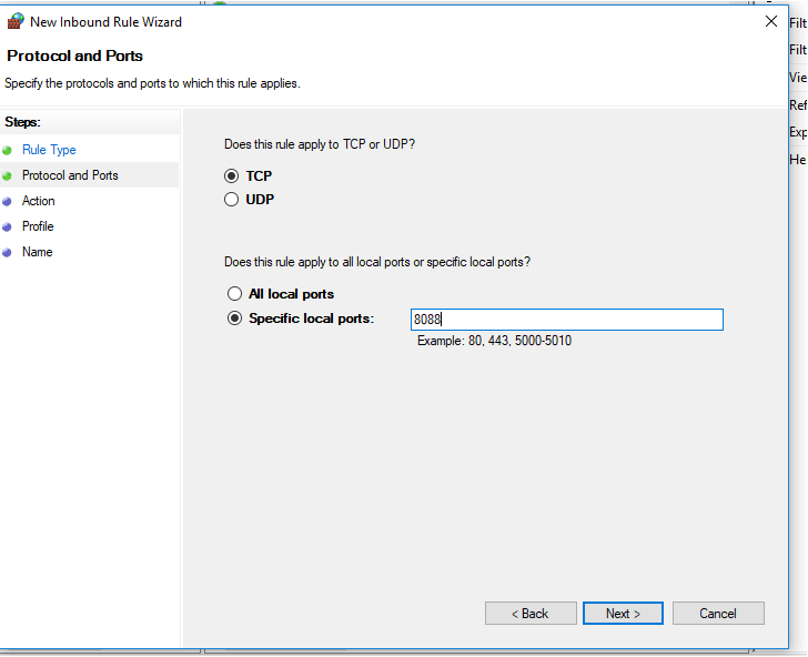

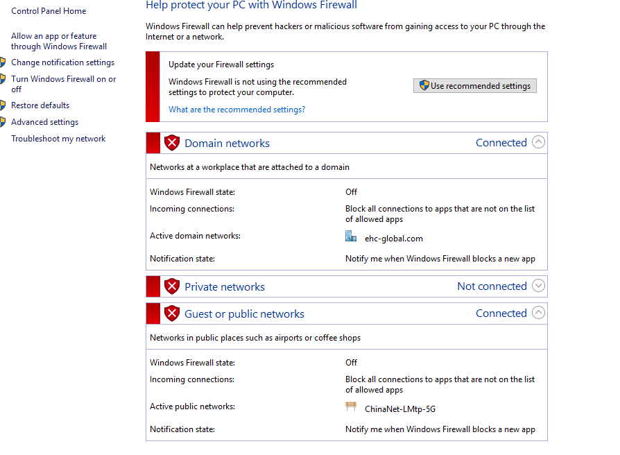

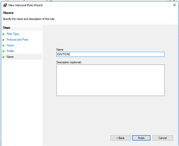

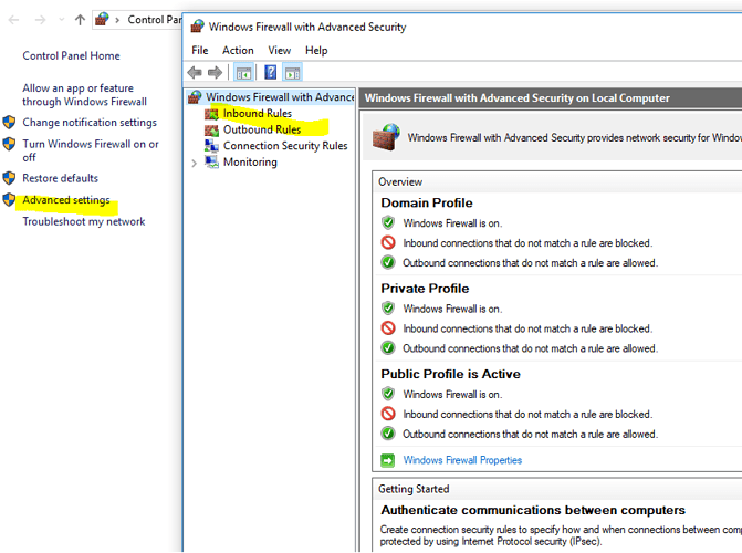

 ![image](https://us1.discourse-cdn.com/inductiveautomation/original/2X/2/224dcf49aad77df594fb6ef2d6e24d03bc1d3939.png)
if i turn off the firewall the gateway can be access
so i open the 8088 port, as the following action, it works
 ![image](https://us1.discourse-cdn.com/inductiveautomation/original/2X/d/dcc009df3cb3b3ea6d38bd384d37cc0687473170.png)

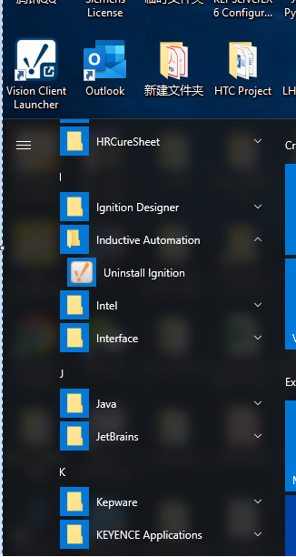

but last but not least, my previous version is 7.9.10, after i update from 7.9.10 to 8.0.10RC1, i can’t see the gateway in the start screen , so i have to uninstall and install the ignition again , thanks for your help.
