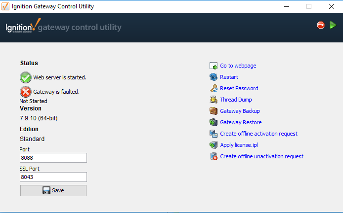

I have the following error: I tried to restart Ignition Gateway, when I tried to Restart, It showed me this…
 ![GCU](https://us1.discourse-cdn.com/inductiveautomation/original/2X/b/b72917edaea59f0bafb6ac6acddbbb670c47592e.png)
When I got the Thread Dump File It showed me this…
[ThreadDump.txt](https://us1.discourse-cdn.com/inductiveautomation/original/2X/8/8313511b2fd497708417220ada391c04d775deb8.txt) (19.8 KB)
I looked in different forums, and I tried to back up my gateway with a .gwbk file and nothing works, please can someone help me ?
**Post date:** [June 27, 2019, 8:46pm UTC](https://forum.inductiveautomation.com/t/ignition-gateway-is-faulted/26155/2 "2019-06-27T20:46:23Z")
You need to look in the logs (`Program Files/Inductive Automation/Ignition/logs/wrapper.log`) to see why the service is failing.

**Post date:** [June 27, 2019, 9:06pm UTC](https://forum.inductiveautomation.com/t/ignition-gateway-is-faulted/26155/4 "2019-06-27T21:06:37Z")
There’s a gateway backup file sitting in the install dir (or data dir?) with a filename ending in “-disabled” that is preventing to the gateway from starting.
**Post date:** [June 27, 2019, 9:08pm UTC](https://forum.inductiveautomation.com/t/ignition-gateway-is-faulted/26155/5 "2019-06-27T21:08:56Z")
That’s a bug that’s fixed in 7.9.11, by the way.

**Post date:** [June 27, 2019, 9:26pm UTC](https://forum.inductiveautomation.com/t/ignition-gateway-is-faulted/26155/10 "2019-06-27T21:26:42Z")
There’s an error in one of your modules (a Sepasoft module, specifically):

Go to `Program Files/Inductive Automation/Ignition/user-lib/modules` and delete the OEEDT module .modl file. You won’t lost any _configuration_ data, just the file itself. You may just need to have the correct version, but that’s not guaranteed.

**Post date:** [June 27, 2019, 9:45pm UTC](https://forum.inductiveautomation.com/t/ignition-gateway-is-faulted/26155/12 "2019-06-27T21:45:47Z")
![image](https://us1.discourse-cdn.com/inductiveautomation/original/2X/3/3fe26630b932f866df301e95801bfa7e16e32d20.png)
You should only have one of these. The conflict between them is likely what is causing the gateway to fail.

It worked!, I delete all the modules I upgrated and it worked, thank you. How do I push solved for this problem?
