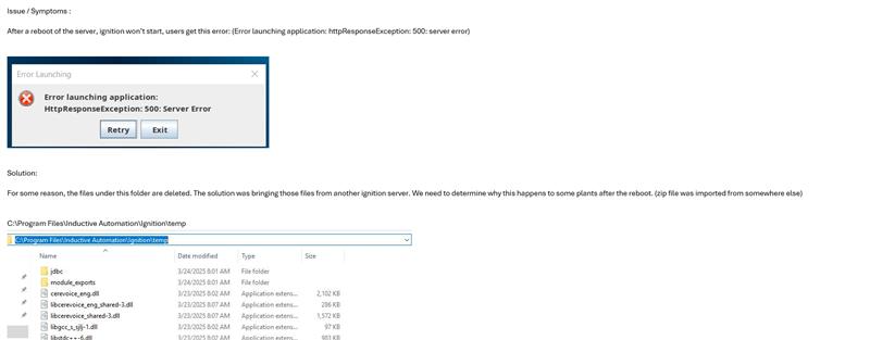

Good morning, I have been presented with a situation on several occasions in one of my ignition servers, at the time of any reboot or update in the ignition software does not start automatically and I get the error “the file 'C:\Program Files ‘InductiveAutomation ’Ignition ‘libruntime ’jre-winelib” “cfg” might be removed after the windows update event. cfg' might be removed after the windows update event.” I know how to solve it, but I wonder what can cause this error, if there is a correct way to do the restart, or something that can avoid this error, or if anyone knows the root cause.

This sounds like an endpoint protection system that is running on the server. What, if any, endpoint protection is being run on the server?
