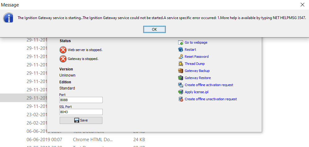

Hello Team,
Previously I was working with Ignition v8 and I did not use it for like 3-4 months. Suddenly when I tried starting Ignition Gateway or tried to launch a designer, it threw an error saying cannot reach site. I did some forum research and all. But none worked.
Hence I downgraded the version from v8 to v7.9 and after installation my gateway won’t start. It shows following error,
 ![image](https://us1.discourse-cdn.com/inductiveautomation/original/2X/0/0835bd0fdbe80b4e7c2e4f0d523147d418586bc5.png)
I tried to increase its Java heap memory size + I also tried to uninstall microsoft EMC, however I couldn’t find it in my laptop.
My laptop specs: Windows 10
RAM: 8 gb
Memory: 1 TB
Please see below wrapper log,

**Author:** ![gljuk](https://avatars.discourse-cdn.com/v4/letter/g/90ced4/32.png) [@gljuk](https://forum.inductiveautomation.com/u/gljuk)\
**Post date:** [July 30, 2020, 6:47am UTC](https://forum.inductiveautomation.com/t/ignition-gateway-not-starting-after-long-time/32278/10 "2020-07-30T06:47:26Z")
Hi!
Started to make a new thread, then i saw this thread. The same situation here. Was running 8.0.12 and did not touch it for 2-3 months. It died by itself. Now i can not start the gateway. I have tried to uninstall it, deleted all the folders from “Program Files” and tried clean instlall from EXE. The 8.0.15 install does not start, the 8.0.12 installer installs ignition, but the gateway does not start then. Are there any workarounds?
Using Windows 2019 server x64.
Thanks in advance ![Ignition8 start log.zip|attachment](https://us1.discourse-cdn.com/inductiveautomation/original/3X/1/a/1a43a9977cdb9b6367ee1f019061777ffb21fe9a.zip) (27.5 KB)
**Post date:** [July 30, 2020, 10:33am UTC](https://forum.inductiveautomation.com/t/ignition-gateway-not-starting-after-long-time/32278/12 "2020-07-30T10:33:44Z")
Ignition service is not running. When i am trying to start the service, i have the error message “Windows coult not start the ignition Gateway on Local Computer For more information, review the system event log. If this is a non-Microsoft service, contact the service vendor, and refer to service-specific error code 1”.
Thanks
**Post date:** [July 30, 2020, 11:44am UTC](https://forum.inductiveautomation.com/t/ignition-gateway-not-starting-after-long-time/32278/13 "2020-07-30T11:44:42Z")
Look in the wrapper log file in the install directory.

**Post date:** [July 31, 2020, 3:18pm UTC](https://forum.inductiveautomation.com/t/ignition-gateway-not-starting-after-long-time/32278/18 "2020-07-31T15:18:24Z")
@gljuk, is your gateway running in a virtual machine?
[https://bugs.openjdk.java.net/browse/JDK-8238596](https://bugs.openjdk.java.net/browse/JDK-8238596)
A duplicate of the bug pretty exactly matches your hs\_err\_pid file:
[https://bugs.openjdk.java.net/browse/JDK-8238246](https://bugs.openjdk.java.net/browse/JDK-8238246)
There’s a possible workaround mentioned until we release a version of Ignition that bundles a fixed Java version - in `ignition.conf`, in the Ignition installation directory, find the `wrapper.java.additional` section. Find the last index that isn’t commented out, and add a new item:
`wrapper.java.additional.4=-XX:UseAVX=0`.
**Post date:** [August 4, 2020, 6:38am UTC](https://forum.inductiveautomation.com/t/ignition-gateway-not-starting-after-long-time/32278/19 "2020-08-04T06:38:42Z")
Thank you so much! Got the gateway running now! Now i will try to update the ignition, since now i am running the version, that has been crushed by itselt, 8.0.12
