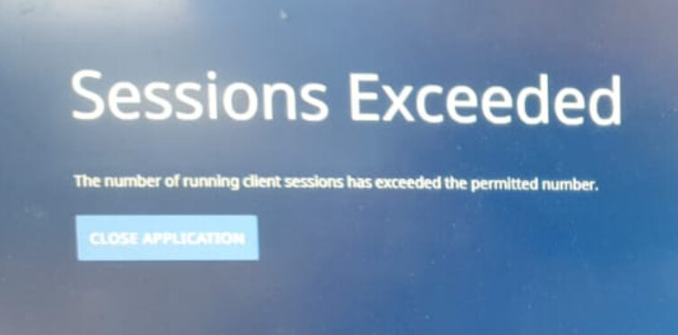

Hi Team,
We have an Ignition license that allows a maximum of three sessions. However, we’re facing an issue where, even after a user logs out and closes the Perspective workstation, the Gateway still shows a total of three active sessions.
As a result, when another user tries to log in, an error appears indicating that the session limit has been exceeded.
Thank you in advance for your assistance and cooperation.
 ![image](https://us1.discourse-cdn.com/inductiveautomation/original/3X/3/e/3ee695268e2ebecfba6d611753a9f05cad2ab5e5.jpeg)
 ![image](https://us1.discourse-cdn.com/inductiveautomation/original/3X/f/6/f67047ea2f98615f450763d322dd8a51a4f12d41.png)
**Post date:** [November 4, 2025, 12:08pm UTC](https://forum.inductiveautomation.com/t/ignition-license-session-issue/111921/2 "2025-11-04T12:08:56Z")
Sessions have an idle timeout. If closed abruptly at the browser, there's no notification to the gateway, and the session will continue to exist until it times out. Set a short timeout.

Hi Pturmel,
Thanks for your advice. Could you please guide me on how to set the idle timeout and where it can be configured exactly?
**Post date:** [November 4, 2025, 12:49pm UTC](https://forum.inductiveautomation.com/t/ignition-license-session-issue/111921/4 "2025-11-04T12:49:00Z")
> [@TechEnlive](#):
> exactly
No, I don't have a designer open at this moment. But it is a project property. 🤷‍♂️

![image](https://us1.discourse-cdn.com/inductiveautomation/original/3X/3/3/3394f4ebeb5909fa4275867ce64f945cb12a6987.png)

Thanks pturmel and tgarrison.
