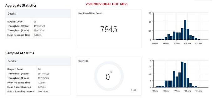

I recently decided it was time to actually test the theories with scan rates for different structures in the PLC, and found the results below.
What I found (obviously) backed Phil's recommendations to only read UDT tags and to _ensure_ that _all members_ of them are set to at least read access. However what I found was negligible difference in response rate at 100ms when reading the UDT tags from within different structures (e.g. individual UDT instances at the root/controller level, addressing UDTs within an array, or addressing aliases to UDTs within an array)
Ignition request scan rate for all tests (except one): **100ms**
Number of instances read: 250 (+800ish UDT tags outside of the test, however all are set to ext access = read/write)
Driver used: IA's Logix driver
PLC: L82
| **Test** | **Tag Count** | **Actual PLC Response Rate** | **Request Count** |
| Individual UDT instances | 7845 | 100.39ms | 20 |
| **Individual UDT instances, Scan rate set to 1ms, CIP Connection Size = 4000** | 6787 | 1.05ms | 2 |
| Array of UDT instances | 7845 | 101.19ms | 21 |
| Aliases to each item in an Array of UDT instances | 7872 | 100.69ms | 21 |
| **AOIs** with same tags as in UDTs | 7899 | **978.20ms** | 303 |
| Individual UDT instances _with a single member set to External Access = None (Note: SCADA didn't actually read this tag)_ | 7845 | **714ms** | 20 |
(all members set to read/write ext. access)
 ![image](https://us1.discourse-cdn.com/inductiveautomation/original/3X/d/9/d97f381701b271d19503c72709481cb28f88c754.jpeg)
