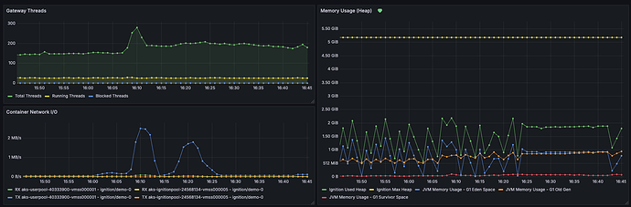

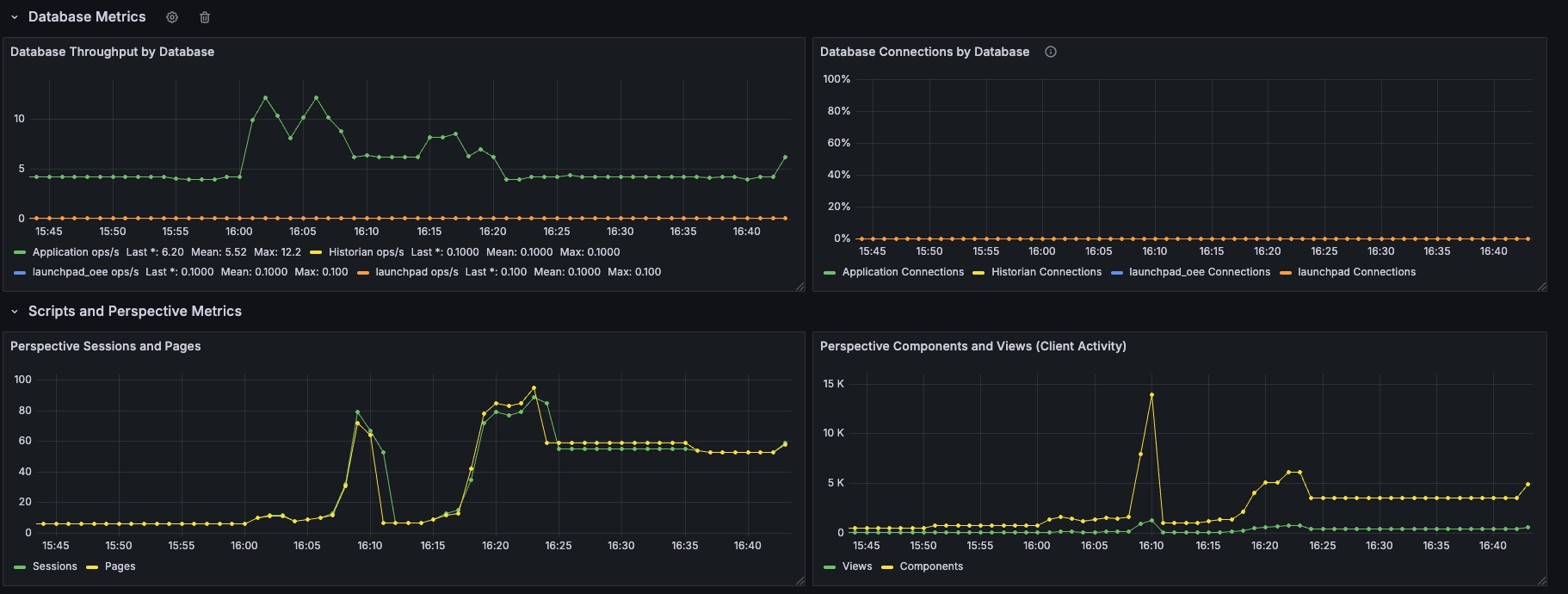

## Dashboard Screen Shots
 ![image-20250912-194149](https://us1.discourse-cdn.com/inductiveautomation/original/3X/e/7/e7cd20008dcfb73051604f9856335ba5cfc94c27.png)
 ![image-20250912-194647](https://us1.discourse-cdn.com/inductiveautomation/original/3X/b/1/b1d298c2b206fad71e41095ce341cb6f6813ca0d.png)
 ![image-20250912-194346](https://us1.discourse-cdn.com/inductiveautomation/original/3X/a/5/a538f6ec7347e7d052565d063c8d07dfcf12cb88.png)
 ![image-20250911-043035](https://us1.discourse-cdn.com/inductiveautomation/original/3X/c/1/c170cdee362ac678f4147f3ae076cf065eb9e19b.png)
 ![image-20250912-194535](https://us1.discourse-cdn.com/inductiveautomation/original/3X/c/7/c70b724b73f16752a0ee8a96225fab33c4cef9c1.png)

With the above information gathered, we built a unified dashboard designed to bring together all the signals needed to identify issues and understand system behavior. Instead of bouncing between tools, we can see infrastructure, broker, databases, and Ignition health in one place.
Here are the sections of the dashboard and some details about each one:
**Key metrics Overview:**
- CPU%, Memory%, Disk usage, **Perspective sessions** , **DB ops/s** , **Uptime** , **SSL cert expiry**.
- Answers “is the gateway healthy right now?” with color thresholds and 1-hour sparklines.
**System Overview:**
- **Threads** (total/running/blocked) to spot contention.
- **JVM heap vs max** + G1 pools (Eden/Old/Survivor) and GC pauses for memory pressure.
- **Container I/O/CPU/RSS** and **network RX/TX** to separate JVM issues from cgroup or node constraints.
**Database Metrics:**
- **Throughput (ops/s) & connections** per DB.
- Optional latency/p95 if exposed; correlates with disk and network to explain slowdowns.
**Perspective Metrics:**
- **Sessions & pages** (server load) and **client views/components** (front-end activity).
- Spikes here should align with CPU and script execution.
