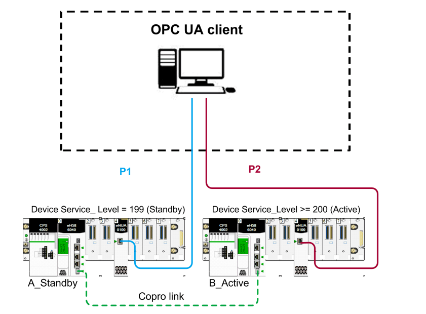

We’re using Ignition SCADA connected via OPC UA to a **redundant Schneider M580 PLC**. Each rack has its own CPU and **BMENUA0100 (NUA)** OPC UA Server module, with fixed IPs. The redundancy follows the **non-transparent server model in warm failover mode**.
The issue is that **Ignition’s OPC UA client only switches servers when communication is lost**. It does **not detect which CPU is Primary**.
As a result, Ignition may connect to the OPC Server on the **Standby CPU** , which doesn’t execute logic. This leads to a situation where **commands are sent but not executed** , even though no error appears in Ignition.
Is there any way to configure Ignition to always connect to the OPC Server on the **active Primary CPU**?
 ![image](https://us1.discourse-cdn.com/inductiveautomation/original/3X/d/a/da059f91c5d70629809b97a407762cc5cbc4ee73.png)

I'm sure Kevin will come along eventually, but I do not think Ignition's OPC UA client supports the OPC UA redundancy specification. At least not the non-transparent modes. (I suppose every client supports transparent?)
I'm not sure if there are more creative way to get this to work or not (e.g. - some script that reads the service level and then triggers a change to the connection config).
**Post date:** [July 11, 2025, 8:29pm UTC](https://forum.inductiveautomation.com/t/ignition-opc-ua-client-failover-problem/108384/3 "2025-07-11T20:29:28Z")
Yeah, there's no _good_ way to do this.
I think some people have hacked it up by monitoring both ServiceLevel variables themselves and then using `system.opc.setServerEnabled` to toggle the connection disabled/enabled, which forces it to attempt to reconnect, starting with the master.
Proper support for OPC UA non-transparent redundancy is on our shorter-term feature list but nothing has been decided in terms of timeline.

Thank you @Kevin.Herron and @Cody_Morgan for your answers.
I’ve configured two separate connections—one for each CPU.
Since most of my tags are inside UDTs, I created a reference tag within each UDT that points to a tag indicating whether the CPU is running as **Primary** or **Standby**.
I added a script on the reference tag that sets a UDT parameter with the name of the desired connection based on the CPU state. Then, I used that parameter in a binding for the OPC source.
I created this topic to confirm whether there was a better or more standard way to handle this.
Thanks again!

Another solution is to create 2 opc tags and a reference tag for each data you read in the plc. You monitor the primary and standby cpu and you write a parameter in each udt that drive the reference tag, for example the parameter is the folder in the path of the opc tag.
This solution is quite robust with a quick failover and all the data switch together.
Creatings tag take more times but when you have have some scripts to generate them that is not a problem.
