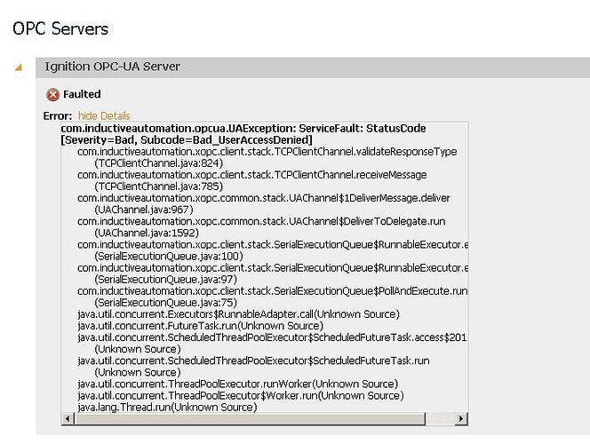

I am getting problems connecting to Ignition OPC-UA Server.
The OPC-UA module is running and the certificates have been Regenerated and the module restarted. It used to work before but since I installed the license and changed the network of my computer it does not work. I post the error here, I hope you can help me.
 ![](https://us1.discourse-cdn.com/inductiveautomation/original/2X/a/a41945ef63b7d6e2c8ff08b0d0557a781e635b37.JPG)
**Post date:** [October 3, 2014, 3:09pm UTC](https://forum.inductiveautomation.com/t/ignition-opc-ua-server-error/9140/2 "2014-10-03T15:09:29Z")
Check the username and password you’ve configured the connection with - the server is telling you that you’ve got it wrong.
