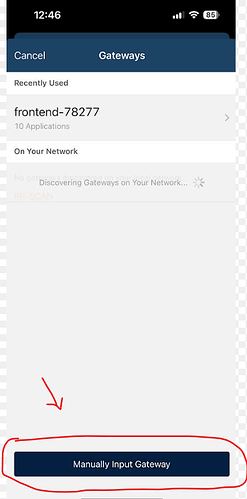

Click on the "Manually Input Gateway" button:
 ![image](https://us1.discourse-cdn.com/inductiveautomation/original/3X/f/0/f031e9c8e95dcc134df0307cb81eabdc7ad4e925.png)
Type "https://[demo.ia.io](http://demo.ia.io/)" into the Gateway URL field:
